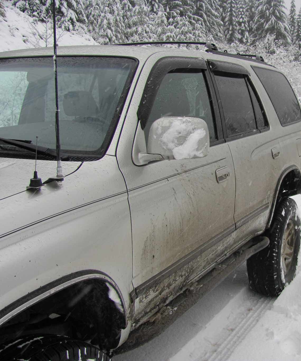

Oh, OK. I looked at doing something similar before. There isn't a lot of room in the fender to do much and keep it looking good. Heres what I did with some parts that were kicking around...

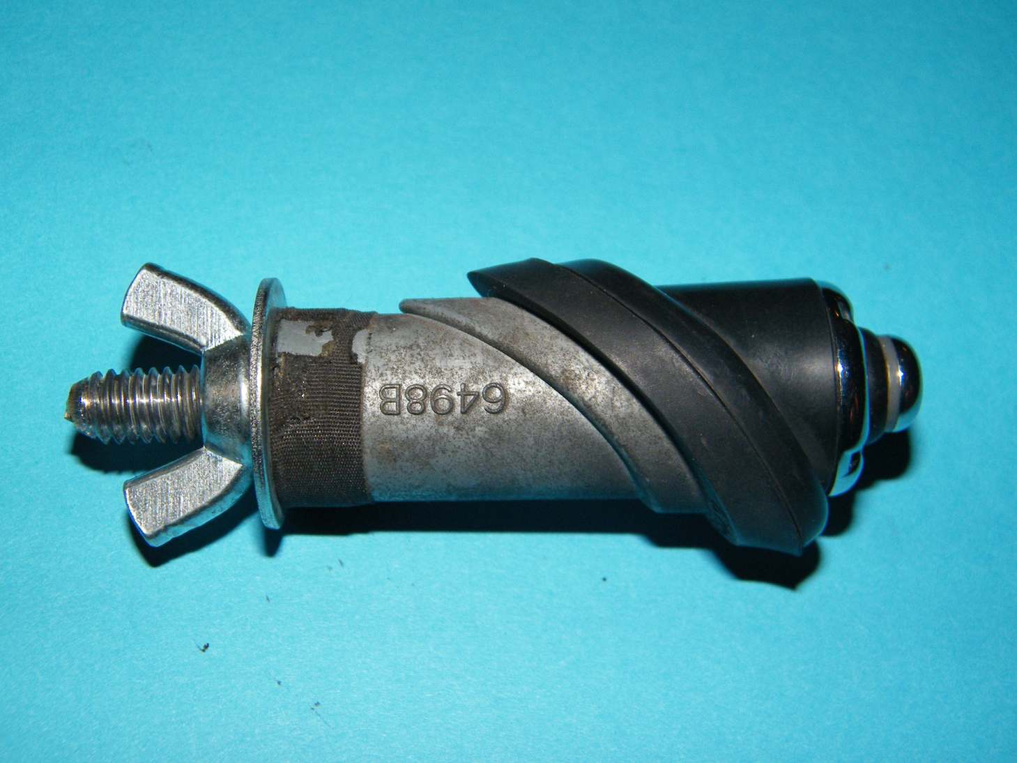

I broke down the power antenna and turned it into a fancy fender hole filler. Used a stainless whip (which was my first CB antenna) for my AM/FM and added a Wilson Flex 4 for the CB. Its mounted on a FireStik hood channel mount.
i did this set up with mine all i did was get a fire stick and gutted all the stock am/fm antenna stuff out and got the aluminum antenna mounts for mounting on a mirror or something if yall know what im talking about and took the one side off and got some good self tapping screws and lined it up with the hole on the finder for the stock antenna and it worked out really good most people ask me were my cb antenna is when they see my cb its that clean looking to me and im still getting a good signal its not stupid high just above my roof but its enough
