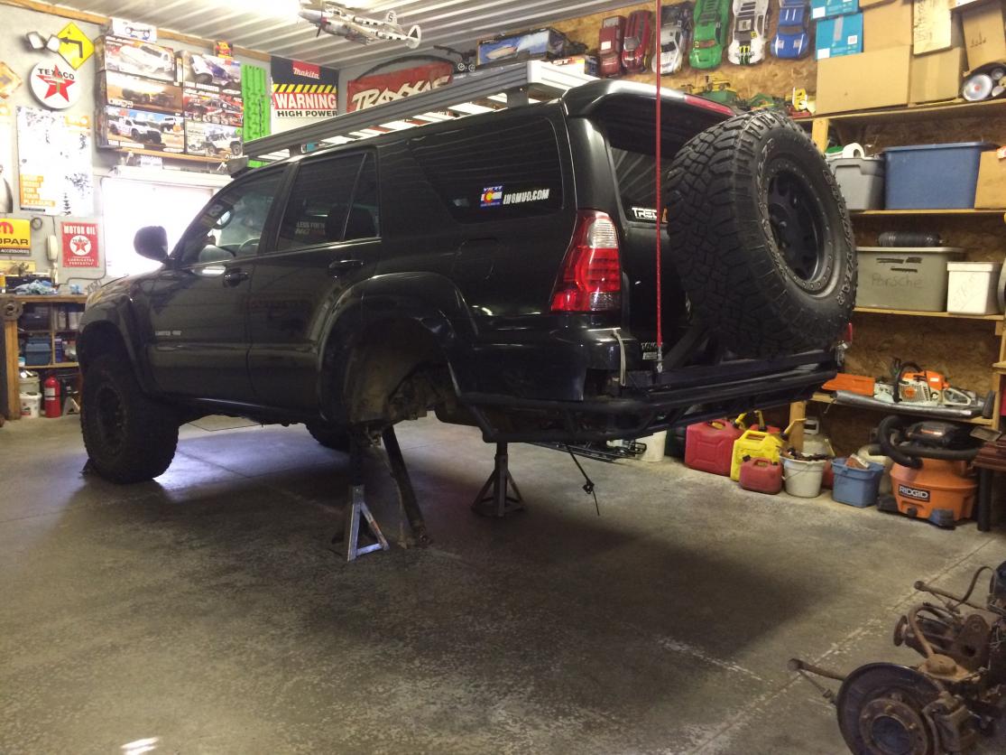

I use the Comet RS720. It attaches to the rear hatch, no drilling or holes. Tighten it down with a allen wrench that comes with it. Not one problem with it considering I've hit too many branches bending the antenna way back.

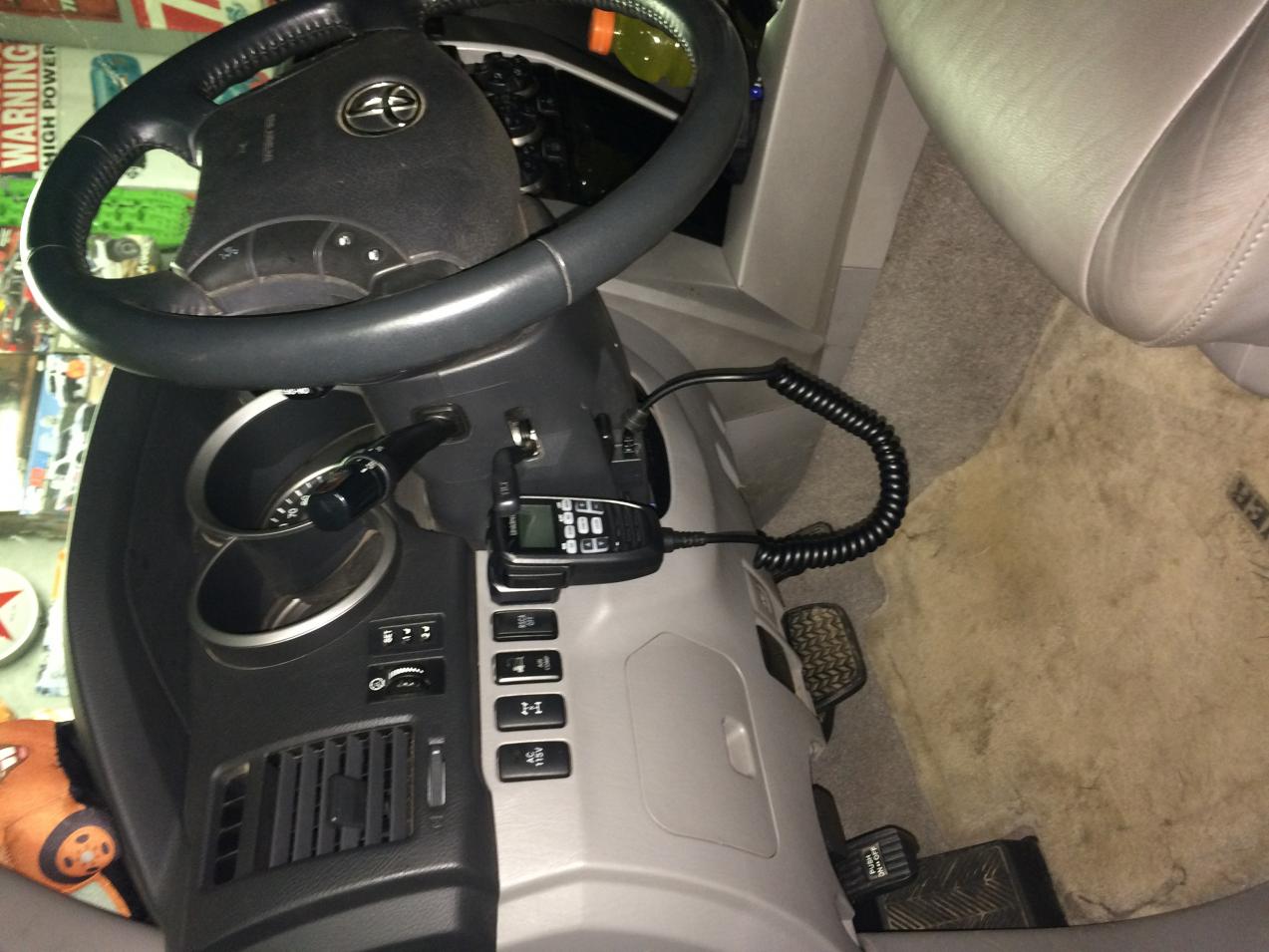

Not that its a quick and easy mounting solution but this is my current setup.
