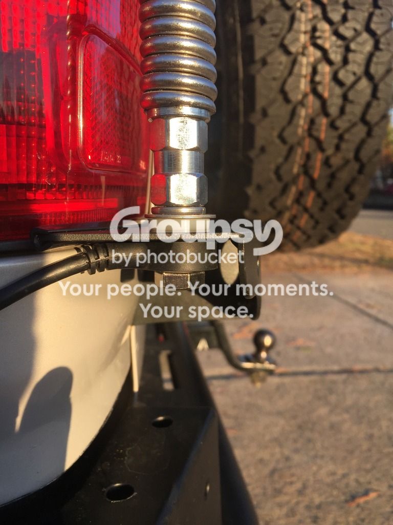

Just finished installing my Mstudt cb radio mount along with my firestik antenna. When i went to just test it, my horn started going off.
Here is how everything is wired:
from battery to bluesea fuse box. From fuse box to the Cobra CB radio. From the radio the firestik cable going to the cb radio mount. Then the firestik antenna, from top to bottom: HD spring, mount adapter, split washer, metal washer, fiber washer, CB RADIO mount, cb radio cable, bolt.
