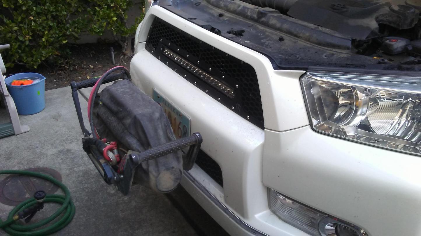

Here is 4runner with front receiver + winch basket

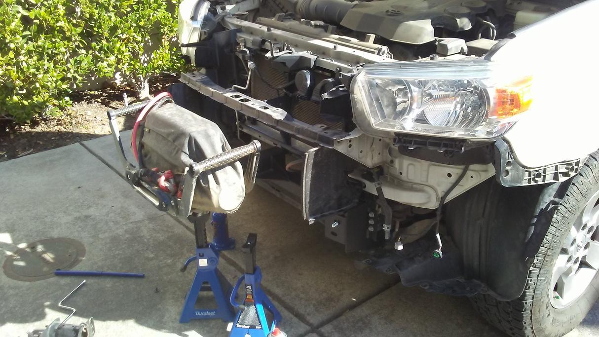

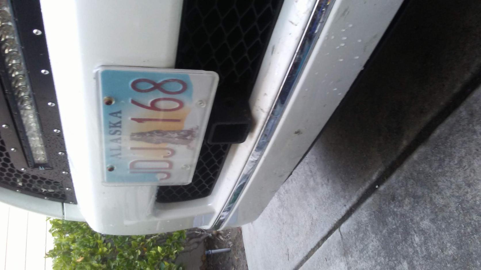

I just mounted the CBI high clearance front receiver hitch on my 2012 SR5. It punches right through the lower grill however it is touching and putting the slightest pressure on the bumper. I'm very happy with it though. Extremely clean looking, and very well built.
