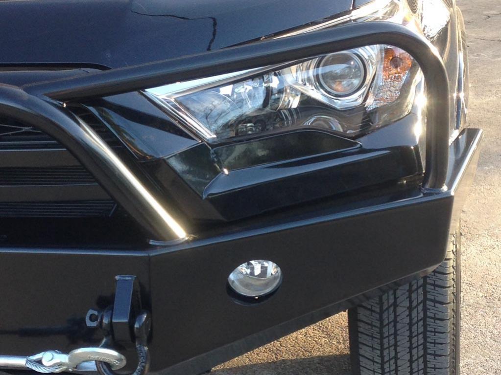

CBI for the win

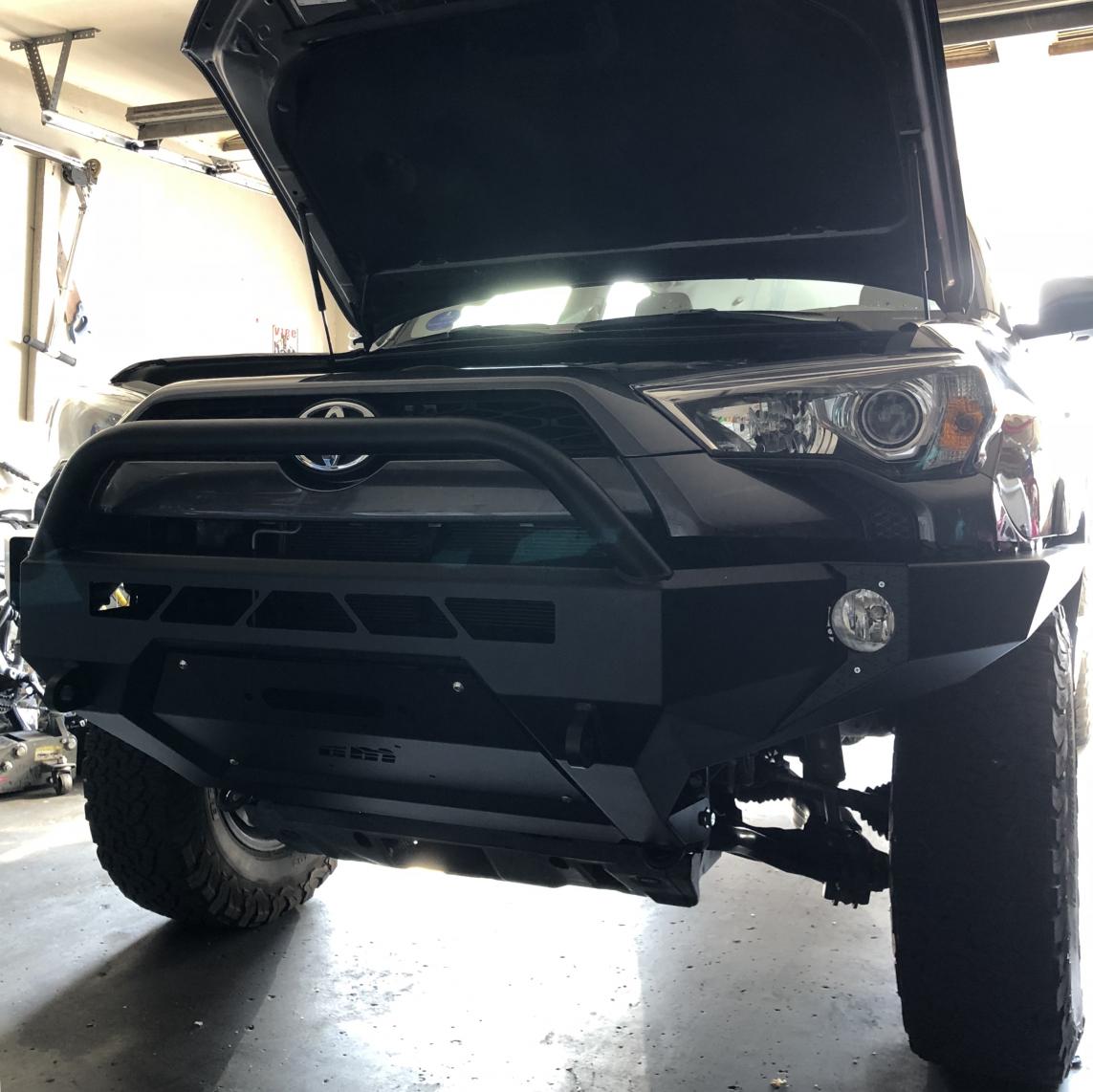

Did you install yourself, or take it somewhere? I'm wondering how much of a pain it is to cut the stock bumpers.

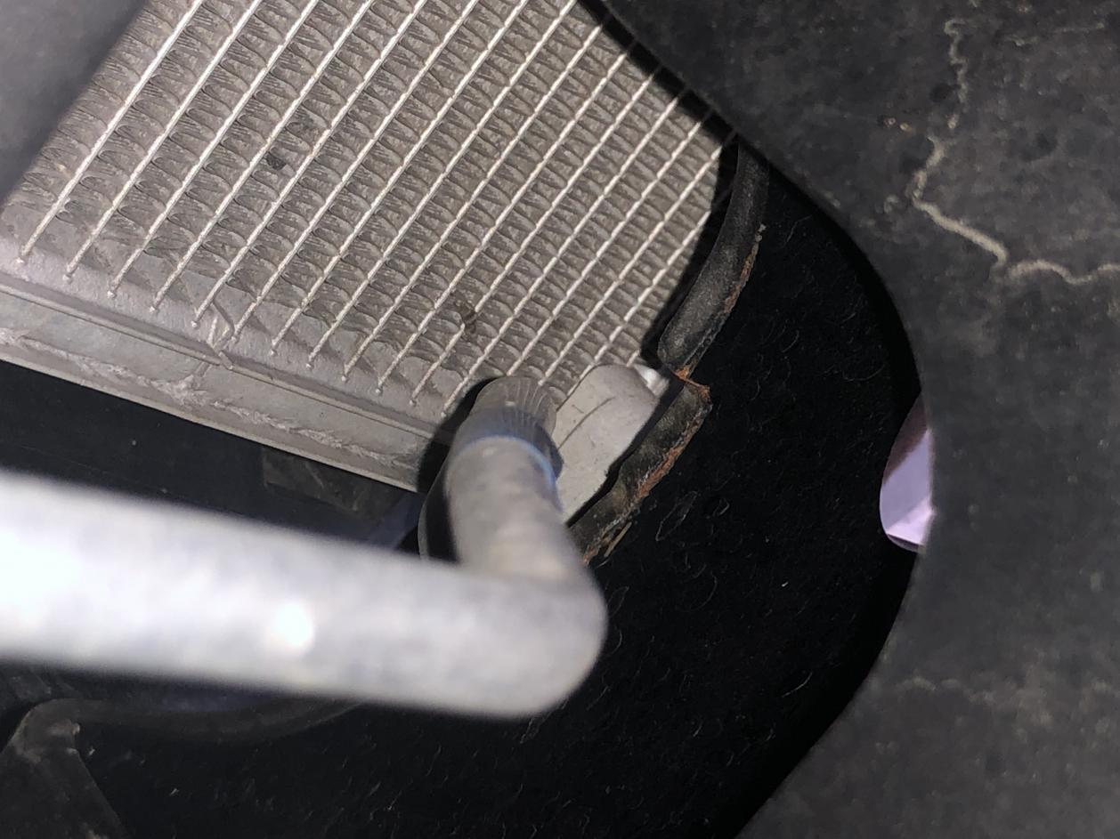

I installed it myself with help from my old man. The instructions from CBI aren’t very clear as to how some pieces should be cut. Just measure multiple times and take your time cutting the bumper and you’ll be good. After I installed it I could hear a rattle coming from the front left area when going over rough roads. Found that the left front fender area where it bolts to the body was rubbing against the bumper. I cut about half an inch off the bumper and now it’s nice and quiet. I also noticed that even thought the bumper has a cutout to allow the AC line to pass through without contact you’ll still get some and in my opinion will eventually cut a hole in the line. I also cut about half an inch off the lower part of the cutout and no more contact.

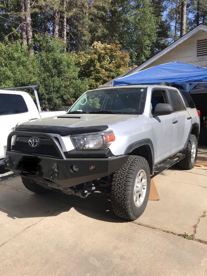

Very happy with my Schrockworks bumpers and sliders. No cutting involved on the front bumper.
