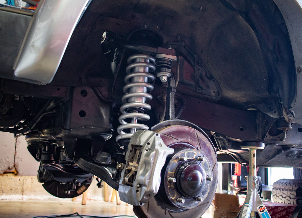

Just waiting on a few more parts to trickle in before starting the suspension. Whiteline LCAB, extended sway bar endlinks, tie rods, steering rack bushings, LBJ bolts, hardware etc. are all on the way.
10 months later and I am finally working on the suspension; I work slow :noidea:
I figured I'm far enough in it to start documenting it now.
To recap, I'm installing the following:
-SS 1.2 Kit with 2.5 Radflo coilovers
-SPC UCA's and ball joints
-OEM LBJ's
-Whiteline Front LCA Bushings
-Whiteline Rear trailing arm bushings
-Energy suspension steering rack bushing
-Energy suspension sway bar bushings
-M Studt extended sway bar end links
-OEM OTR's
I think that about covers it. And sorry for all of crummy cell phone pictures.
First went about cutting off and pressing the UBJ's out.
I couldn't figure out how to get the snap ring on, so I drilled some small holes and used my snap ring pliers.
Uppers installed:
LBJ's were leaking and my driver side castle nut was hand tight, and I didn't even have to press out the ball joint. Scary Scary. I shouldn't have slacked off so long on replacing them.
LCA's out. Used a little jack to keep the axles propped up.
Used a bottle jack to get the bushings out and my press to get the new ones in:
Cleaned up and ready to go back in.
And I threw a new emblem in the front grill. Time to de-gold the back now.
Weekend progress report (Did I mention I work slow? :))
New Whiteline steering rack bushings and steering rack installed (not fully secured and torqued down in this picture):
Control arms back in, LBJ's installed, and got the diff drop in.
New tie rods, boot, sway bar and endlinks installed.
And I splurged and bought some Weathertech floor mats. Also ordered Savage Offroad skids Excited to finish and drive this again!
