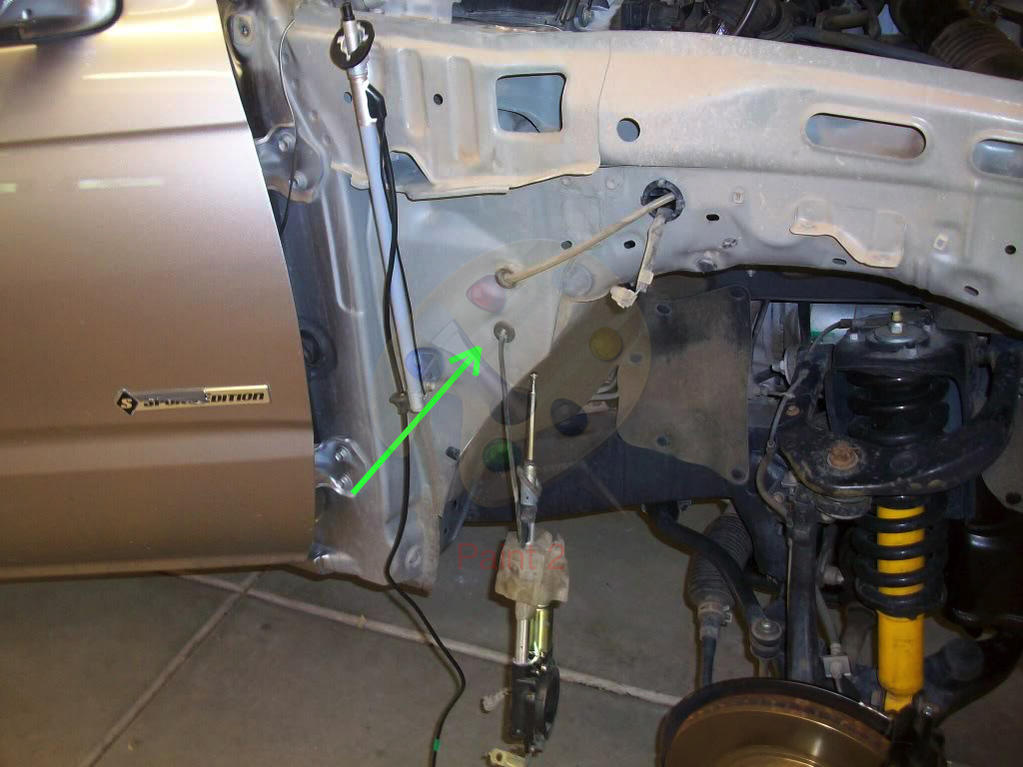

Can you take some pics and/or explain how you rerouted the antenna wire from the glove box area to the stereo? When I took out my antenna, I thought to myself how much of a pain it's going to be to put a new one in.
Unfortunately I did not take any pictures but I can kinda of explain and use some other pictures. Below is a few links for people that have done it
http://www.toyota-4runner.org/3rd-gen-t4rs/70865-non-power-antenna-tacoma-whip.html
The "Taco" Whip Antenna Mod
Once you either take the fender/liner out you will push the antenna cable through the hole into the trucks interior (see green arrow in attachment)
Then move into the the cab of the truck and remove the glove box and trim inside it. (see below)
Also, remove the door sill and kicker panel on passenger side (there is 4 screws and then the kicker panel just pops off when you pull outward gently)
Then what I did is took apart the center trim to remove the radio and unplug the antenna wire. With that removed you can trace the old antenna wire back over the ac line where it is zip tied and clipped long the glove box area (see picture below)
Once all that was done I cut the old antenna at the hole where it enters from outside, pushed the new antenna wire through, taped it on to the old antenna and with one hand pulled the old antenna from the stereo area and fed it up through the glove box area with the other hand (go slow and be gentle as there is some sharp edges you have to snake it around. It will come through just gotta keep at er)
Hopefully that helps and good luck!
