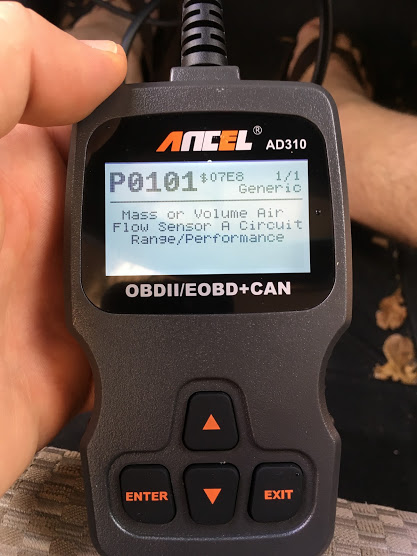

The other week my CEL came on with code P0101 Mass Air Flow Sensor A Circuit Range/Performance. I haven't noticed any kind of rough idle or stuttering but the RPMs do bounce around a bit especially while braking.
I cleaned the MAF sensor with the specific MAF sensor cleaner and cleared the code with my scanner, but the CEL came back on shortly after with the same code.
Just wanted to see if anyone had any other thoughts to remedy this before I buy a new MAF sensor. If I buy a new one, any experiences with aftermarket vs OEM?
