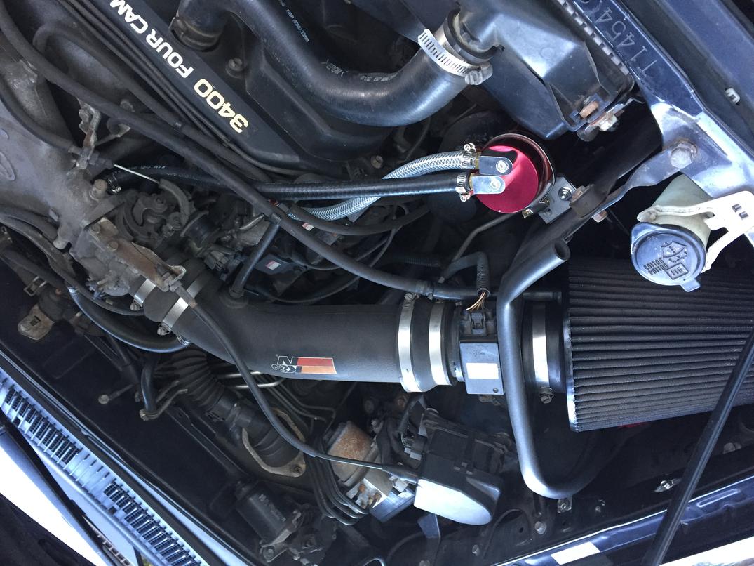

Hey guys,
I just installed a oil catch can yesterday. And while driving home this afternoon the cel come up on my truck. Maybe an air leak somewhere? I know the code means system too lean bank 1. Any help would be great thanks guys
I know this is an old thread, but remove that catch can, and your issue will go away. The computer is sensing that and throwing the code. I did the same thing on my 4.7
