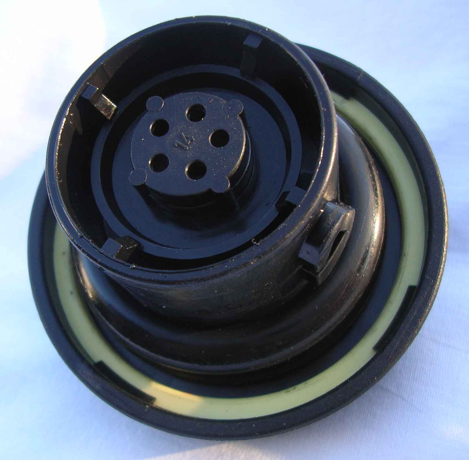

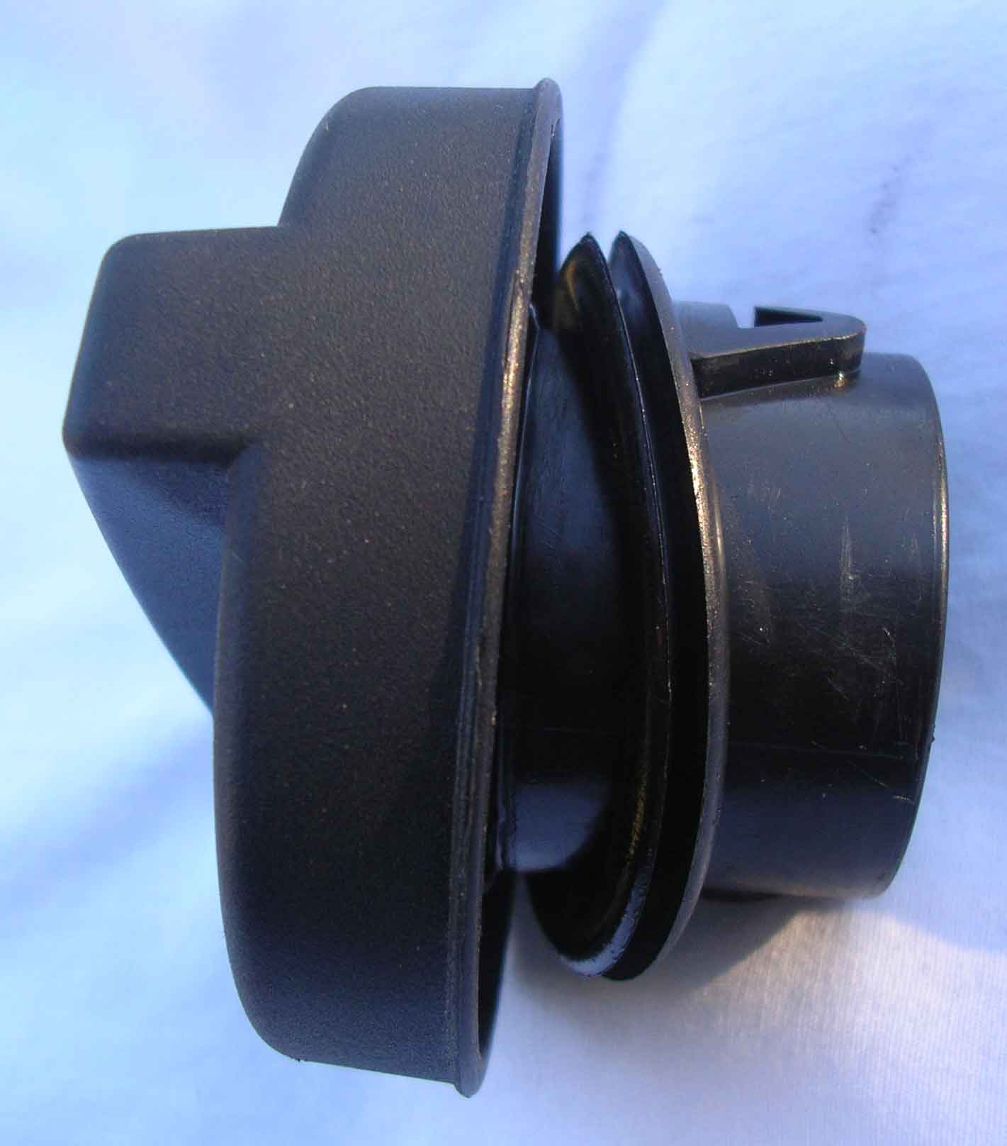

I don't know what the under side of the cap should look like. Here's a couple of pictures. The lose fitting O-ring has a groove around circumference. Is that corrrect?

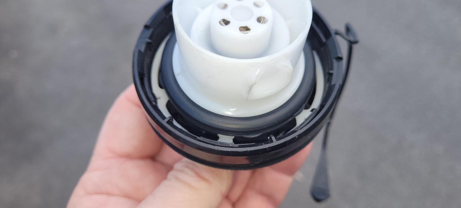

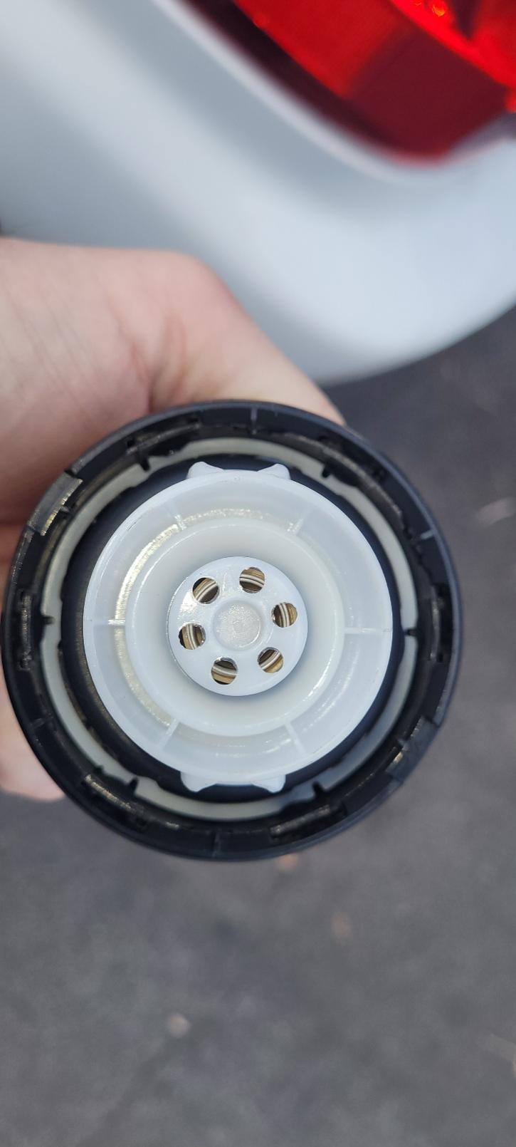

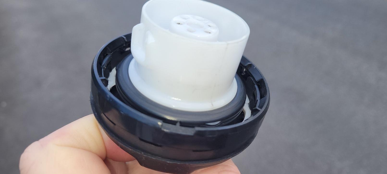

Mine looks different than yours (O-Ring)
in case your wanting to look at it here it is
Amazon.com
As others have said, make sure the filler neck is clean, and free of nicks on the service where cap O-Ring seat.
Always be gentle inserting fuel nozzel in neck to avoid nicking the neck.
Good Luck
