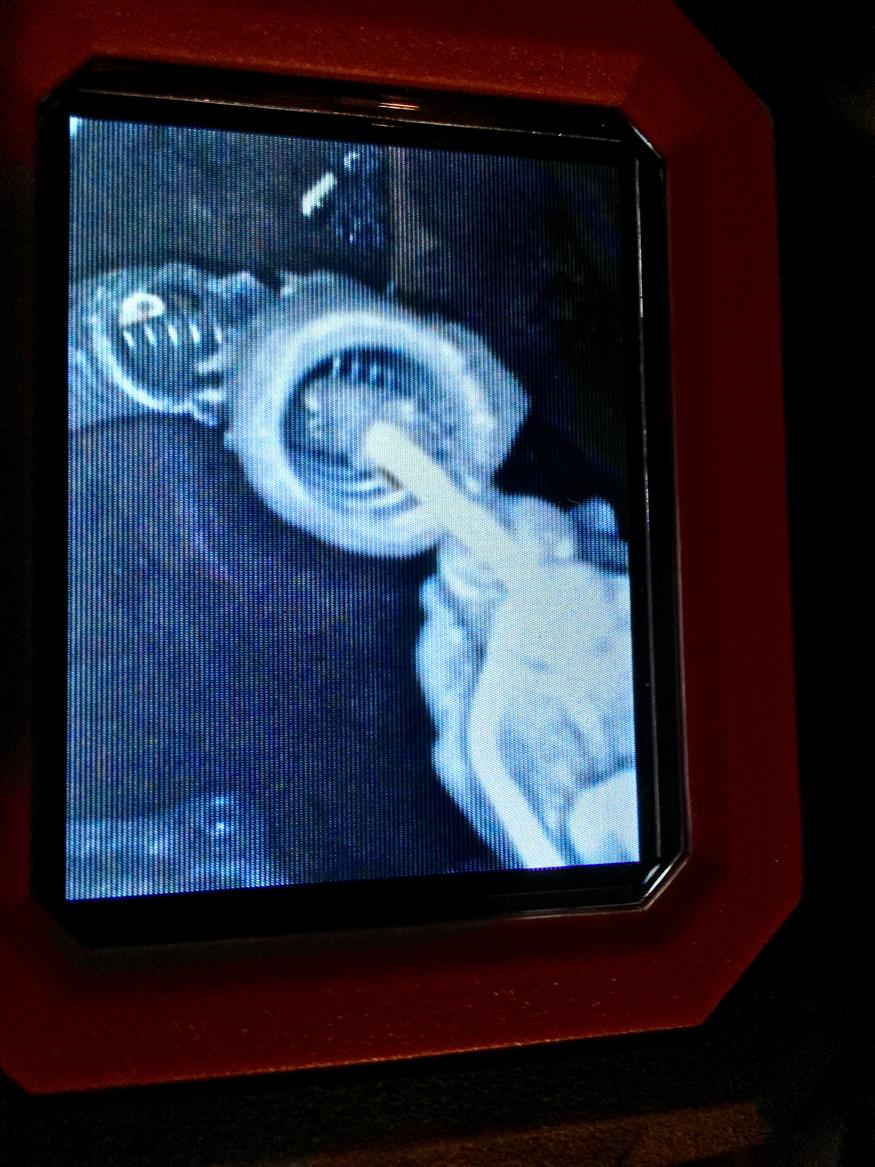

Doing a little research the sensors rarely go bad, but rodents eating the wires is the main culprit. Off to HD I go to get the Milwaukee inspection camera I always wanted and sure enough the wires are cut. I usually garage my 4R but came home late and left it outside, temps dropped lower than usual and I guess they couldn't resist. Im lucky that they didnt chew the wires right off the connector, it should be easy to solder in some new wire. There is no sub harness for the knock sensors and I assume the dealer would want to replace the whole engine harness at $2478 so Ill be tackling this repair myself this weekend.

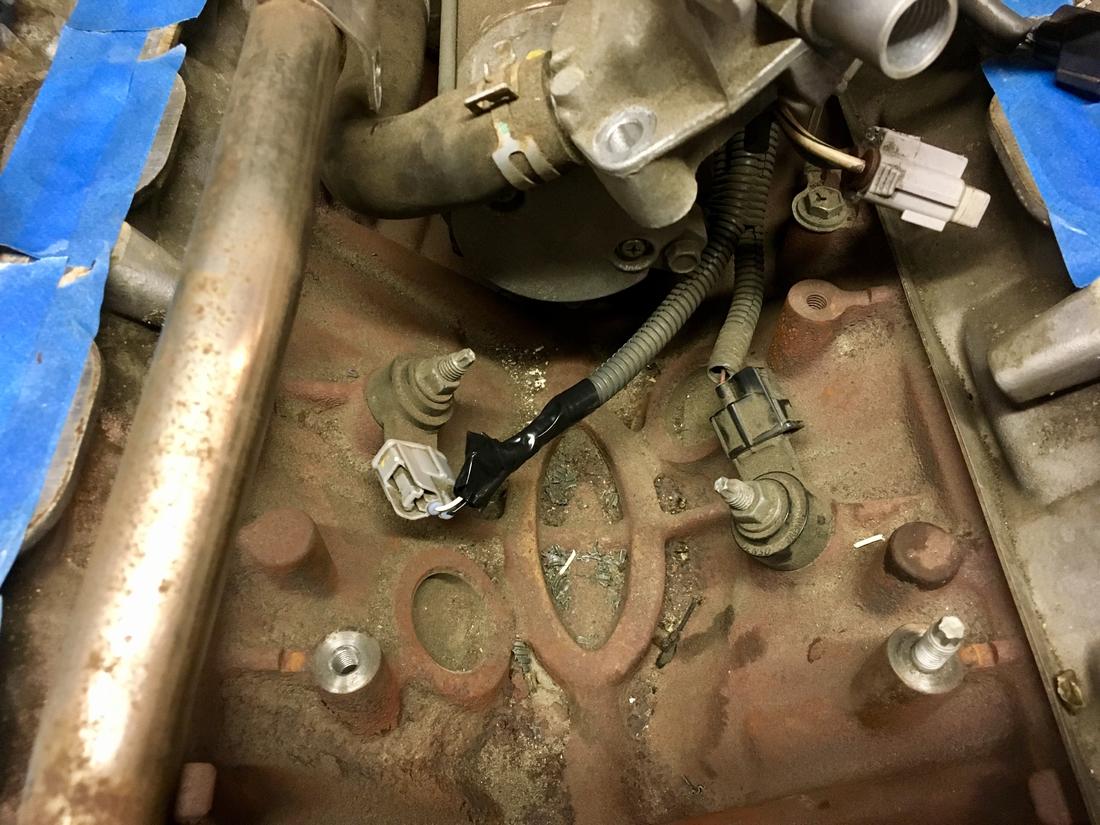

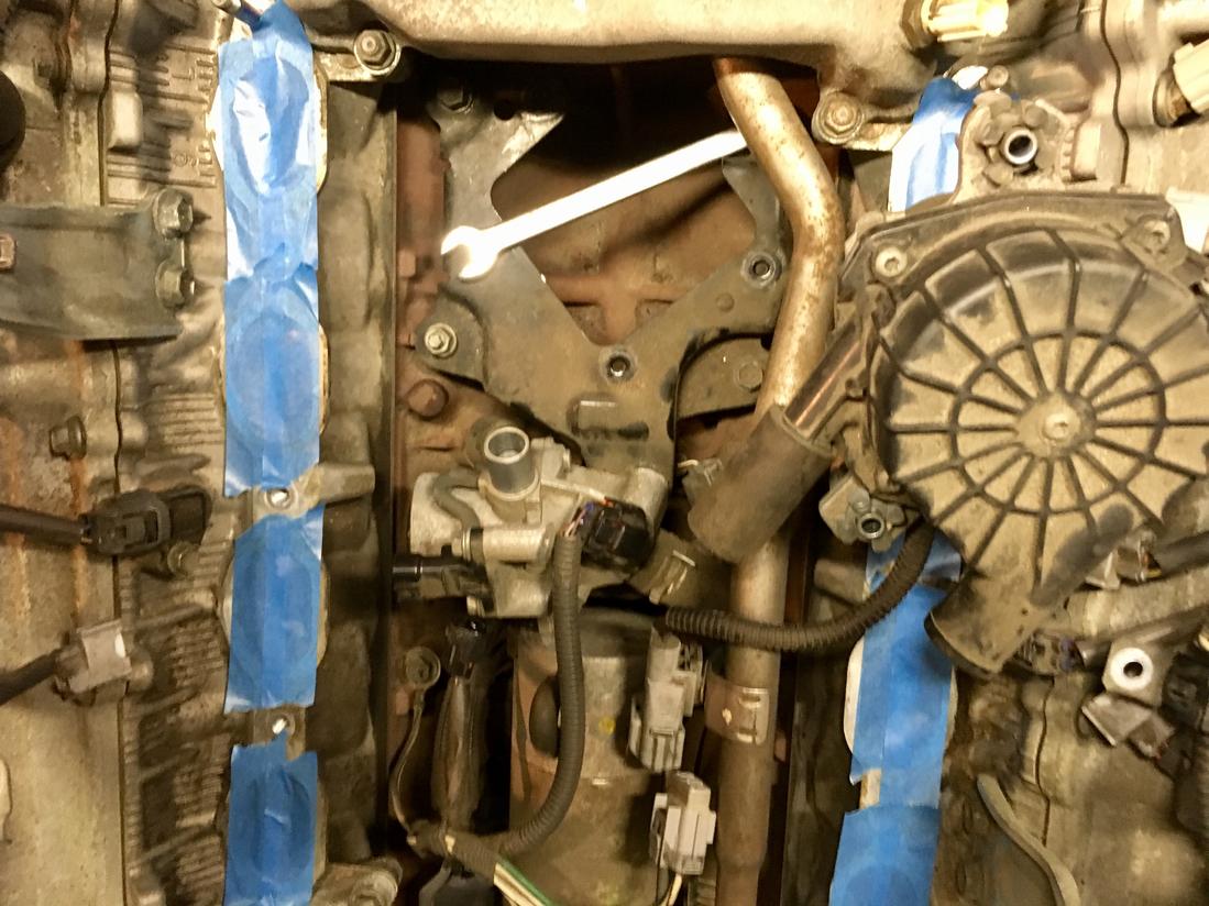

Fixed in about 5 hours, no big deal. Should have changed out the AIP while I was in there but I should have it down to a couple hours next time.

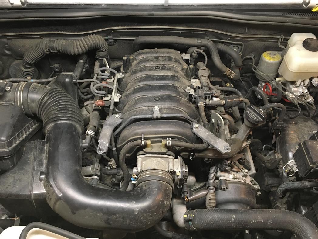

Took a pic before I started to make sure I had everything as it was.

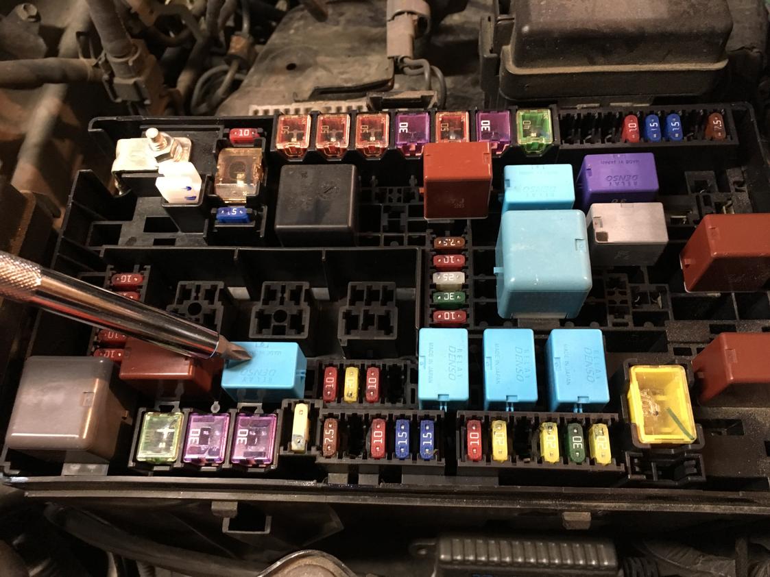

Pull the fuse to open the fuel circuit, open the gas cap, then let it run until it dies.

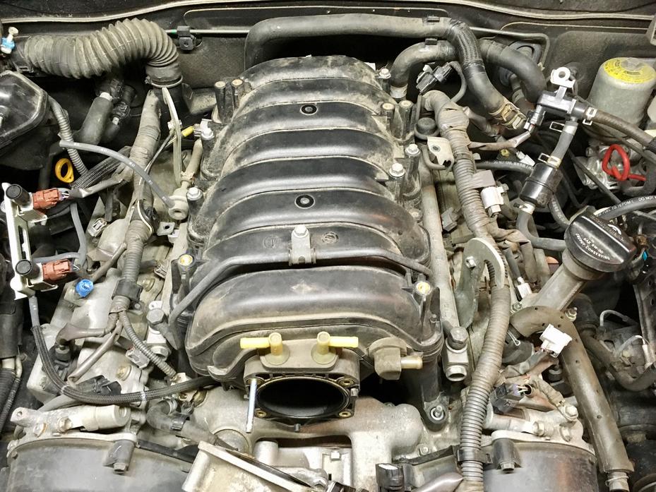

The FSM says to drain the coolant, but I just took the TB off instead. This made things a bit of a challenge later on. Ready to remove intake manifold.

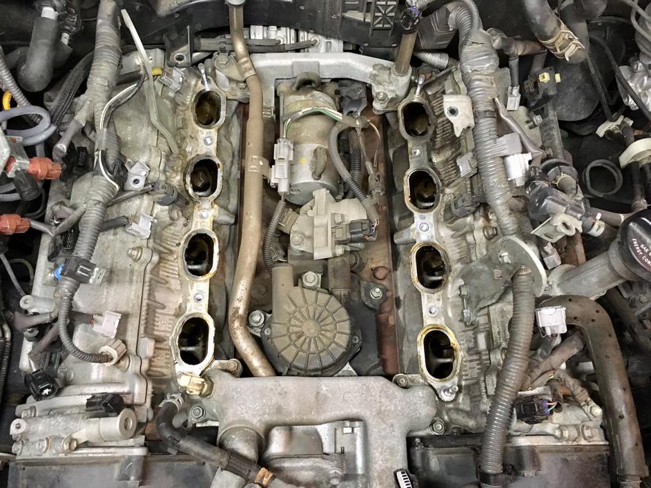

Intake removed to reveal AIP, starter, and water bypass pipe.

Since I didnt drain the coolant, I couldn't remove the water bypass pipe like the FSM said to. So I unbolted the AIP from the bracket and wiggled it out, then removed the bracket. The pipe is blocking the FWD LH nut from overhead access so have to come from the side. Might be able to thread a 1/4" extension through the gap.

I had just enough wire still attached to just solder the ends together. Applied heat shrink, then electrical tape, then plastic hose covering back on.
Started her up, all conditions normal. It took me about 3 hours to break everything down, an hour to repair/clean up, then an hour to reassemble.
Took it slow and read the FSM, had no issues. A magnetic tool retriever and small flashlight were useful. On a couple bolts in the back I had to swap around my sockets and extensions from shallow to deep and 3-6-9" to make things a bit easier.

How did you use the camera to view the knock connector? Entry point?

Hi @GMZ. This post is incredibly helpful. May I ask what was your point of entry when you used the endoscope to find the damage?
