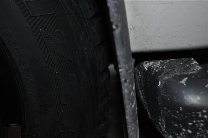

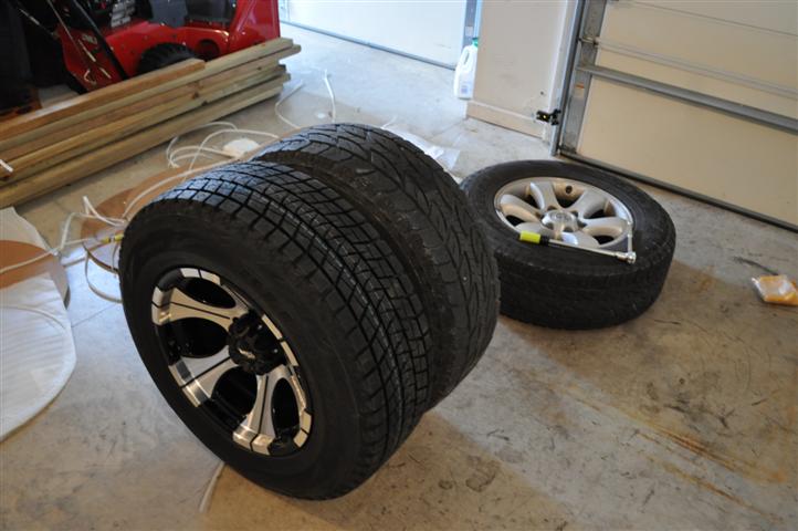

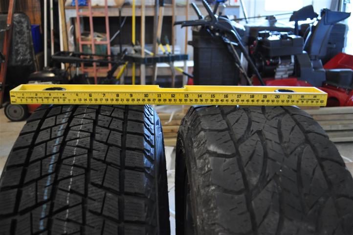

The tires stick out about a half inch, the fourth shot shows this. The tires are about the same height as the Revo 265/65/R17 I have on the stock wheels (the Revos have about 50k miles so they have lost a good bit of tread).

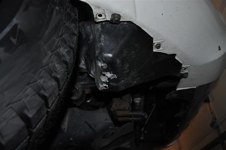

The front fender liners and front mud flaps have about a 1/2" of clearance at rest with the steering at full lock, except on the passenger side where the tire presses into the fender (pic 120, 6th down). Following J.A.s method, I unscrewed the four 10mm (head) bolts that hold that part of the liner in place, push it back about a 1.5 inches, then secured the bolts back in place through new holes and sheet metal backing (1x1" that I snipped). The next shot (pic 123, 7th down & 8th too) shows about a 1 inch gap between the tire and the relocated liner. I think I may get light rubbing under other conditions (full-lock and compression) and will look for scuffs and repeat the process above as needed.
I'd recommend the DC-2 wheels and 265/65R17 size if you're willing to make these minor adjustments to the fender liners as needed.
