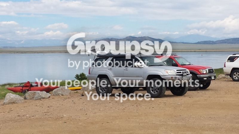

Another update to the thread:
Finally added a pair of Rigid's I had sitting in my garage, and an ARB awning. Have an ARB RTT now too, but that may be added to an expo trailer that I'm going to start building this winter. I'll definitely have provisions to mount the RTT to the rack of this 4runner and my rock buggy. Also got some 285 duratracs and my favorite toyota wheels, no rubbing anywhere, I thought I'd have to do the body mount chop, but they fit great.
Anyways, posted these in the pic thread, but I'll post em' here also for my reference later.
Fishing out about 2 hours from home:
