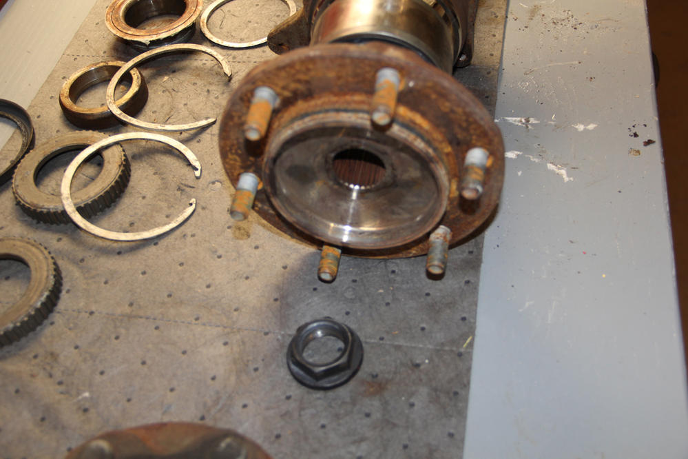

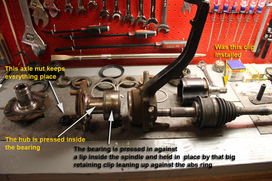

I just so happen to have them laid out on my bench after I've pressed everything out. I also have my original OEM axles that I just replaced. I took a picture for you to help you think out loud about your scenario.
As you can see the main axle bearing is pressed into the spindle against a lip. Once installed there's a big C clip that fits in a groove on the hub side of the spindle. In the photo, the clip is leaning against the ABS ring.
The hub is pressed into the main bearing and the only thing keeping the hub in place is the axle and the nut. As you know, all it takes is one good whack with the hammer to get that axle out of there to change out CV's.
If the nut wasn't properly torqued it may have given the axle just enough play to "rock" the main bearing causing it to fail. I don't know, just surmising.
Since you purchased an aftermarket axle that was fully assembled, did it have the clip installed on the tulip? You should have heard a solid click when you installed it.

I thought the tulip was inside the boot, I heard a solid click when I hammered them into the front differential

Yes that clip was installed, sorry just saw your text on the picture.
