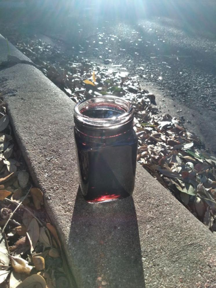

+1 Its all i ever do, turkey baster suck out and refill several times. Here's what the last removal looked like, sun wouldn't even shine thru it, haha.
The power steering works well despite. Luck all.
