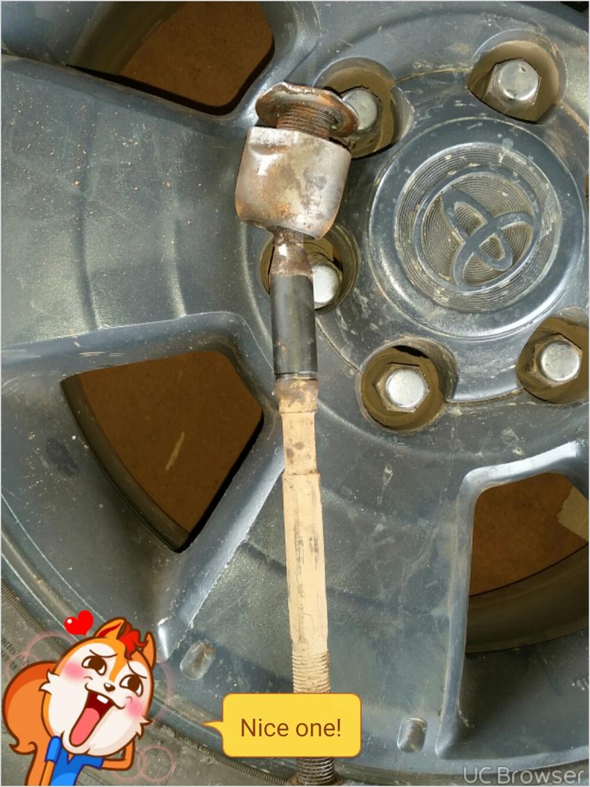

Had the shakes n tire play at 3 n 9 oclock.so knew my steering knuckle was bad..went to the mechanic...who removed it and confirmed same....twas replaced..went for an alignment car was aligned..drove home...found out ..steering wasnt centered...went back for alignment at a different place...tech aligns and says..he needs to loosen n adjust the steering wheel itself as he has aligned it perfectly from underneath the car..but steering is still off a bit.
So my question is : is it normal to adjust the stèering wheel during alignment...or do i take it back to the original mechanic to try and correct his initial installation of the steering knuckle?
See what was changed

Yep, you need to find a shop that knows what they are doing. Hard to trust someone that doesn't know what part they replaced.
Sorry for the error ...yeah its inner tie rod.

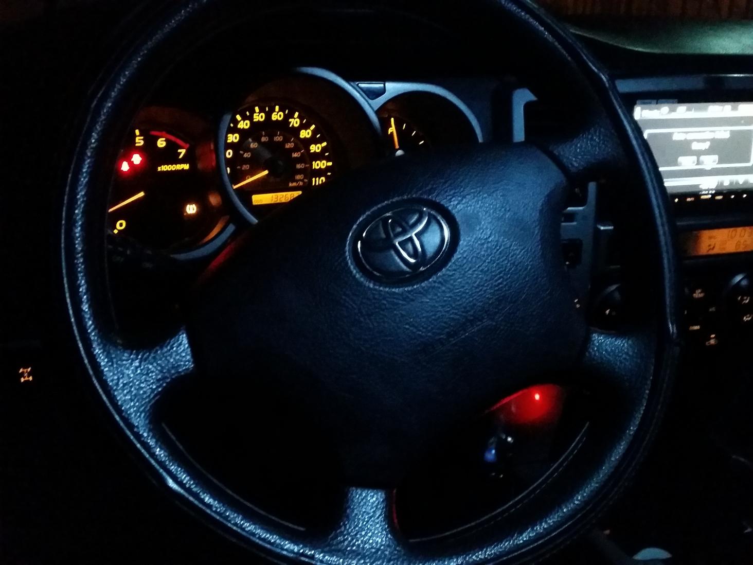

attached is a pic of how the steering needs to be before the car can go straight.
if the steering wheel is firmly kep staright,,,the car will go a lil bit to one side, though in both scenarios, the tire appears to still point straight.....i hope am making sense

To straighten the steering wheel isn't it just adjusting the tie rod ends? I admit it's been a long time since I did this kind of work myself but that's what I'm now recalling. Loosen one side, tighten the other?
^ Yes.
I was an alignment tech for small stint in my early 20s (helped at the family shop). You center the steering wheel, loosen the tie rods, turn them until the tires are parallel with the frame, then adjust toe equally on each tie rod in small increments until you have the correct spec.
Of course this was before laser alignment setups and we did things differently and much more accurately. That tech is an idiot, you NEVER remove the steering wheel to center it. I'd go back to that shop and talk to the manager/owner.
^ Yes.
Actually I just did this on a Sienna that had a rack put in it incorrectly a while back. Sometimes you do need to remove the steering wheel to recenter the vehicle.
I this case you set the steering rack to center, adjust the tie rods to equal lengths, after which you then set the steering wheel, shaft, and clock spring to the center positions and perform your alignment from there. The idea is that sometimes if a technician is not paying attention and/or the shaft is twisted when the rack is being replaced or the tie rods are not set to similar lengths as the old rack was it will put the steering wheel too far off-center. Though in this case I would have set the new tie rod as close to the old one as possible to avoid having it that far out of center.
ok [MENTION=66389]BlackWorksInc[/MENTION] , this implies that the alignment guy could have been right when he said the mechanic that fixed the tierod was careless
going forward, which would you advise?
1. i take the truck back to the mechanic who installed the tie rod and get him to try and reinstall the tie rod correctly..after which i can then go for alignment.
2. i allow the alignment tech to remove the steering wheel and adjust it for the alignment
If they are saying that with the wheels straight ahead and the threads being fairly even on the tie rods, the steering wheel use still very crooked; then recentering the steering wheel by removing the shaft is a viable option that the alignment shop is more than capable of doing. It all just depends on how lazy the alignment so is being in regards to "the steering wheel isn't straight. "
That's after changing the steering rack, not replacing a tie rod end. Those aren't fun either and you have to have the exact turn count from side to side before hooking the steering wheel up in order to be centered. In this case, unless they were messing with the rack, it has to do with the tie rod end alignment. Alignment can absolutely be fine and your steering wheel can be sideways if it wasn't centered to begin with.
