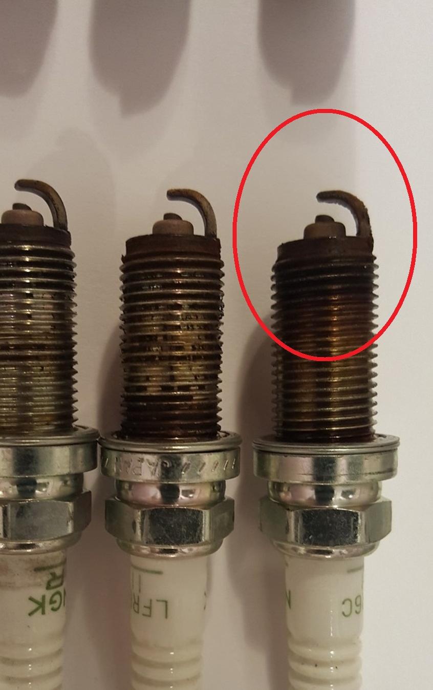

[MENTION=125426]lcbjr77[/MENTION] I don't want to say that you have a problem, but I would be a little concerned about the scaling on your #6 plug. If you look at mine all 6 plugs look about the same, in reviewing yours #6 appears to have build up which could be coolant residue. Something you may want to just keep an eye on. -UPDATE- I just realized you have an 07' so it should have the updated head gasket so this could be nothing at all and simply a coincidence.

Morphious...Thanks for sharing, have you had any issues with your head gasket... I was nervous until I saw your "Update"
Apparently 06-09 have a new design, but only if you have an '06 built in '06, at least according to what I was able to dig up some time ago when I was researching the issue.
Mine was built in Feb 2006 so I'm hoping nothing goes wrong...
