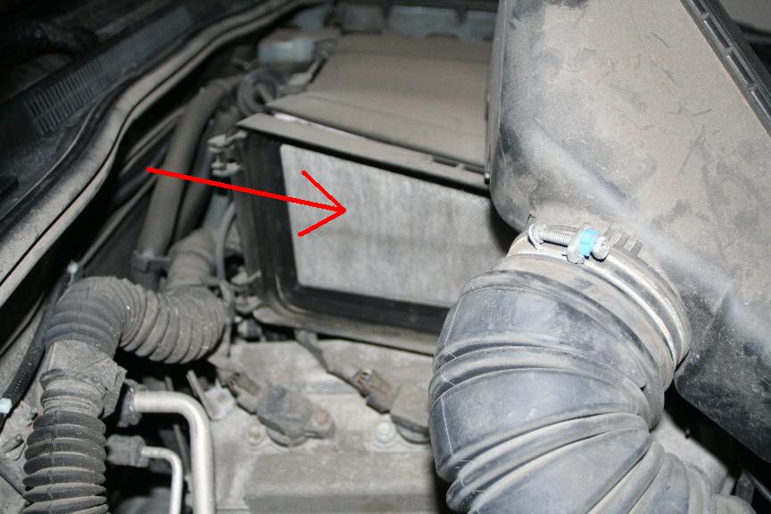

I think I see what is confusing you. Don't be sorry to ask this because others have been confused in the past.
Are you trying to replace the filter I'm pointing at (with the red arrow) in the pic? If so, then this is the non-servicable emissions system charcoal filter. Leave it alone and go to my next post.

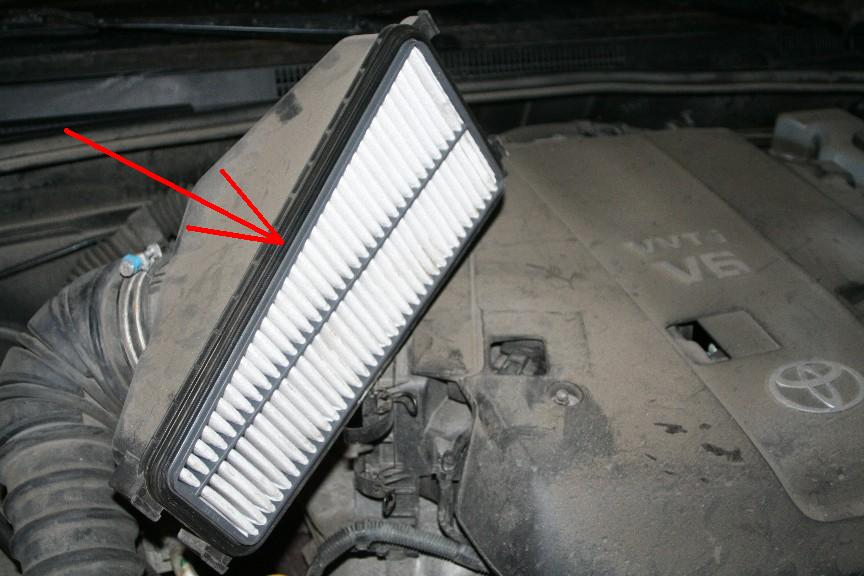

This is the filter you want to change. It pops right out by gripping the edge (red arrow.)
Now I get it. I'm looking in the wrong direction once I un-buckle the housing. Hope I didn't chew up that emission charcoal filter too bad while trying to remove it. Thanks much.

Yup. Just got it changed thanks to the pics. Really makes you feel stupid, however, you pretty much have to lean over the fender to unbuckle the housing and from that vantage point, the only thing you see that looks and is shaped like the air filter, won't come out.
