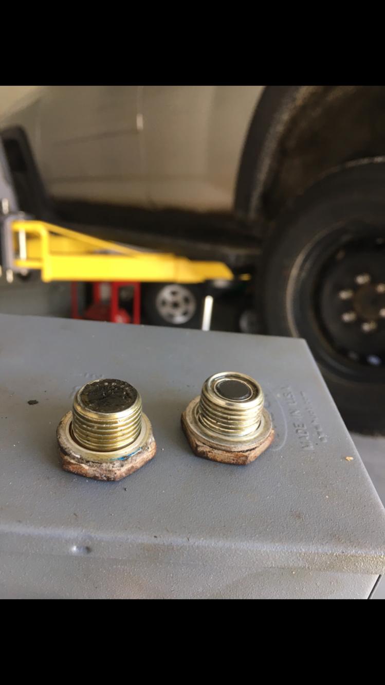

Did TC after 60k miles , fought it cause I usually change my fluids way sooner , trying to get out of that foolishness lol , anyways changed it at 6000 miles when i bought rig new with amsoil 75/90 and installed drain plug magnets for the fill and drain , here is what came off em
and if anyone cares I've been changing oils in Toyota diffs and transferase for over 40 years on my vehicles and have never installed a new crush washer ever and have never once had a leak , some vehicles I had would of had the plugs removed probably 7 times for oil changes and no issue , so don't worry about reusing a crush washer if need be .

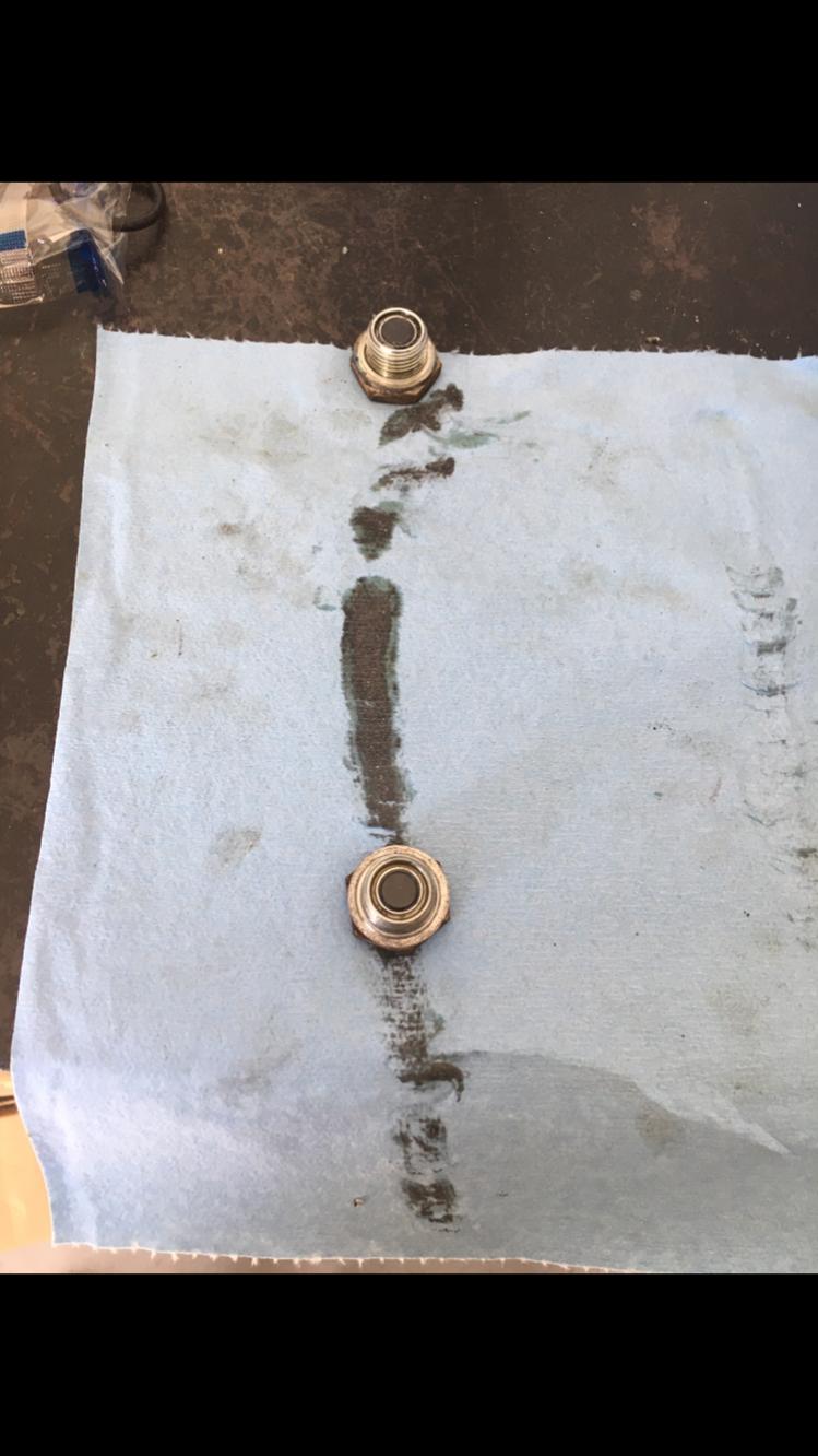

What came off fill and drain mind you i cleaned off the fill every time i changed engine oil so it picked up that amount times 10 or so cleanings .
Also you must remember for rear axles , toyota axle bearing are not in oil bath and they are what cause the most heat and metal particles so in theory the rear oil change intervals should be not as soon as an axle that has axle bearings bathed in the oil , something to ponder , thoughts ?
