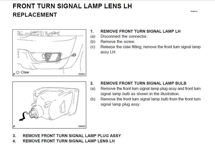

Remove those screws under the front fenders..and push that plastic forward, let somebody hold that plastic sheet, I don't know how it is called, or block with a wood. Meaning, you are going to work in front of the front wheels/tires, so twist the wheels to the max left or right in order to have an angle space depending which side you are going to replace..
The turn signal lamp assembly has one screw and a claw, the claw is located next to the foglamp and is hard to release. One hand will release the claw with aflat screw driver, while the other hand will pull the whole assembly out. Goodluck:cool: or, remove the headlight assembly(for me, it takes time) and have a clear view of the turn signal lamps.

Thanks but I think I described the wrong light!
The bulb I'm trying to change is high up front on the top. I thought it was the turn signal lamp but it must just be the running lights. (I don't have the full time lights and just leave the "extra" lights on all the time).
