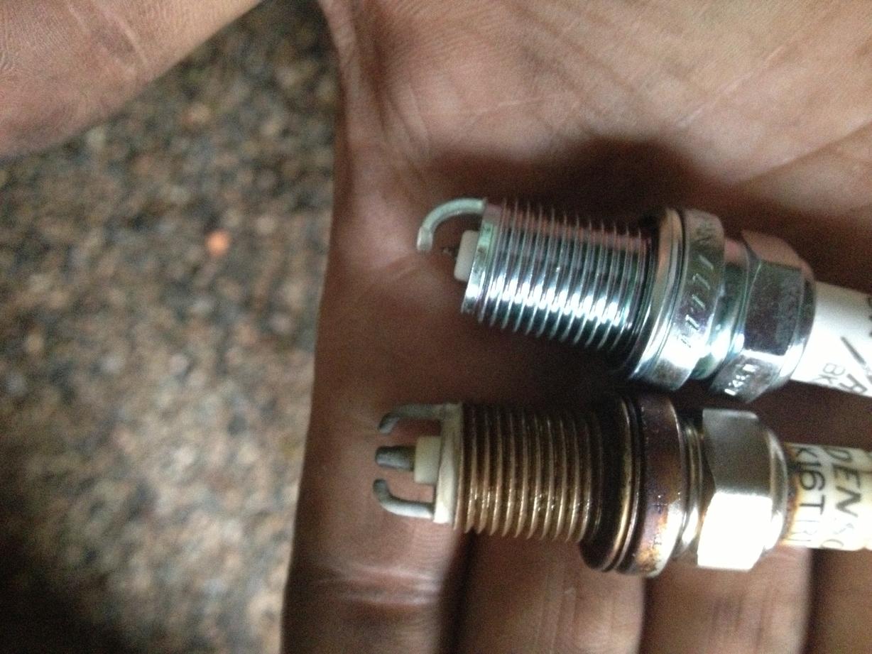

Got some NGK iridium plugs and just noticed they have one igniter rather than the plugs with 2 that I just pulled. Any cons to running these new ones?

Some people say they work fine, some say the will ruin your engine. There is a Toyota sticker on my engine that says use dual ground plugs so those are what I went with.
The reason we have dual ground spark plugs is due to the way our engines are engineered. They have a secondary spark that happens after the first to "clear" the chamber and the reason for the dual ground is for longer lasting and for a more effective spark.
Although the single ground probably would work i believe they will die twice as fast?
But either way NGK actually makes a specific plug just for our 5VZ motors so if it was me i rather go with the NGKs that were made for our motors.
Well... I though this way.....
One igniter gives a spark and that will send a spark to a piston at the compression stroke and to the other piston (through the connected wire) at an exhaust stroke. So a spark plug gets two sparks per crank revolution wearing it twice as fast.
I just switched my plugs from single to the double prongs not too long ago and it made a big difference in performance and even how the engine sounded. I used NGK BKR5EKB-11 got em at O'Reilly for like 4.50 a piece
The 5VZ-FE has a waste spark ignition system. Meaning that the three coils fire twice, per crankshaft rotation.
Each time they fire, they are igniting the A/F mixture in whichever cylinder is on the compression stroke. Be it the cylinder the coil itself is mounted above, or the one it's connected to by a spark plug wire.
The dual copper electrode plugs are speced by Toyota simply for longevity, because each plug fires twice as often as those in a non-waste spark ignition system.
So dual electrode copper plugs, will last twice as long as single electrode copper plugs with the 5VZ-FE ignition system.
Iridium is much more durable than copper, so the Iridium plugs will last longer than a standard single electrode copper plug.
In my own 4Runner, I've been running the NGK single electrode Iridium plugs for ten years now. So far, they've shown significantly less erosion of the electrodes, than the OE dual-electrode copper plugs did at less mileage.
I intend to keep using the NGK Iridium plugs in my 4Runner.
If you install the Iridium plugs, and check the gap, DO NOT use a ramp style plug gap gauge, as they can put too much side stress on the Iridium center electrode, and could break it off. Check and adjust Iridium plugs ONLY with a wire type gauge.
