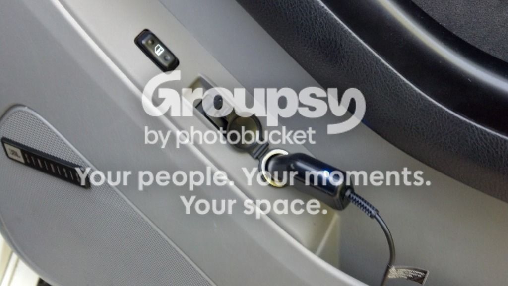

Another one gets the Gshadow mod lol.. Guys we have a Lexus LX470(Landcruiser) and my daughter prefers the Runner for trips just because of this mod :)
IMG_20130613_194331_387.jpg~original
