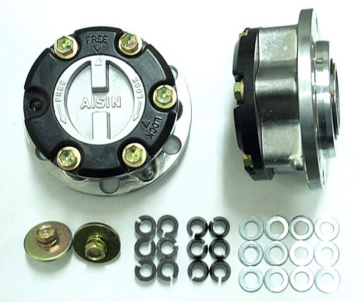

The retaining bolts with captive washer along with the snap rings, studs, conical washers are available at ORS. You can see them in this link, and picture below
"Aisin Hub Lockout Kit - Products" Aisin Hub Lockout Kit - Products - Off Road Solutions
The stud PN is 90080-11282
Give them a call, tell them what you need and they'll put together an order for you with all the individual parts you want, they just don't have them listed on their website for purchase, but they have them. The studs they carry are the correct length, but they are not Toyota oem, they are aftermarket and they are the correct.
Yotamasters also sells a stud kit* for the locking hubs that comes with conical washers lock washers and nuts. They also sell the gaskets for the base and the locking cap.

Those springy cone washers are a PITA to remove, especially when they've been stuck in there for a couple of decades. Mangled all of mine to some extent, and some to a greater extent. And found they're more expensive than I would have thought, IIRC something like 4 or 5 bucks a piece? So I got half a set, and replaced the worst ones, reused the best.
I mostly just took them apart, cleaned all the ancient solidified grease out, and replaced the o-ring on the handle since it was dried and shrunken.
Watch out for the little ball bearing and spring in that handle when disassembling - unless it's stuck in there with dried grease it might pop out and roll off into an alternate dimension. And other than that, take some pics of how the big springs are seated on the handle and locking gizmo, those are a bit unintuitive/quirky in the way they fit together.
Put a nut on the stud (to not mushroom the stud)
Brass drift
3# sledge
Takes 5 or 6 good whacks and the cone washer will pop out
Grease or antisieze before reinstalling
Take the locking cap and dial apart inside a big ziplock bag. An ultrasonic cleaner filled with simple green makes cleaning up all those small parts effortless.
The spring really only fits/works one way so a little quality time will make it all clear. Use some good white lithium grease when reassembling, especially the spring and ball cannon. Turns like butter.
