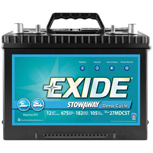

I would imagine that it would be tough to run it all the way down. But i have found a deep cycle marine battery for like 100$ would that be sufficient?
That's hard to predict, but that sounds a little low for one.
Exide Stowaway Deep-Cycle Marine and RV Battery
If all you are running is your fridge you will not run the battery too low to damage it as the fridge has a voltage cut out switch. I would set it such that the fridge cuts out at the lowest voltage possible since this battery is not responsible for cranking duty.

That battery will give you 2-3 days of fridge power if at temperature without running your vehicle. Solar will extend that greatly on your trip. You are good to go with that.
