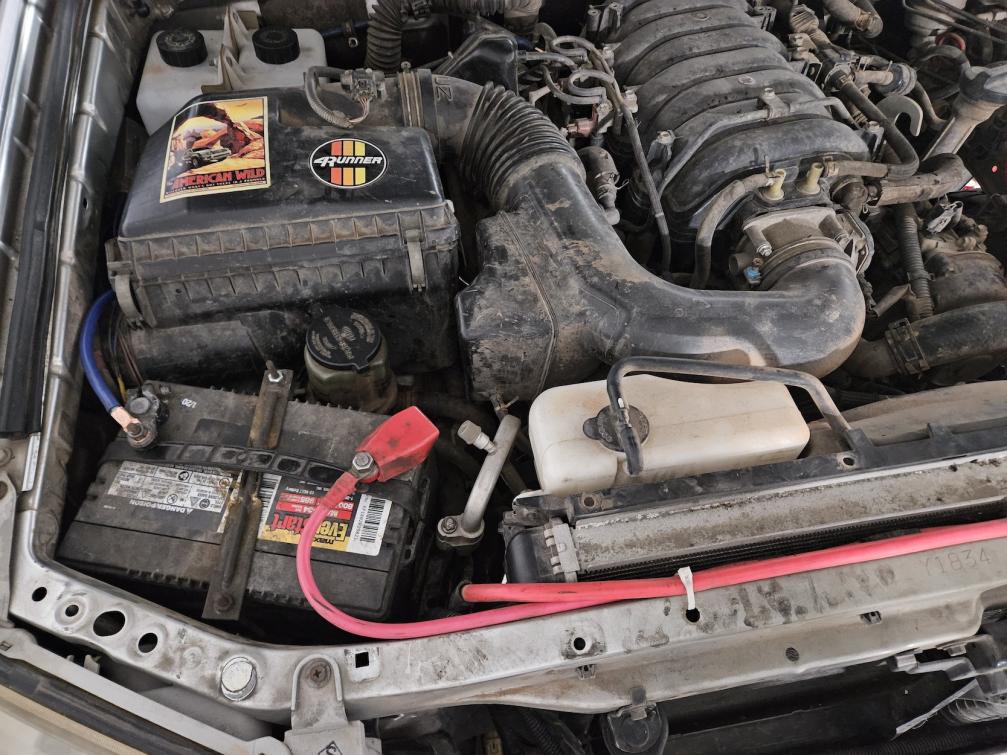

Originally I had this set up in my 07 FJ and removed it to install here on my 08 T4R V8 after adding my winch. I used a Hell Roaring battery isolator (Hellroaring Battery Isolator Combiner, BIC-75150A) and it has worked flawlessly for 15 years between both vehicles. As you can see I moved the power steering reservoir and removed the original windshield washer bottle. I installed two Dorman tanks (ShieldSquare Captcha)( Upper left corner of pic) bolted to some old knock down shelving bracket steel, then connected the hoses at the bottom of the tanks to the washer pump. I extended the wires to the pump motor also. I used a scrap piece of aluminum (3" X 8"X 1/4") as the platform for the battery and bolted it to some existing holes down in that corner. The hold down is kind of funky but it works. The battery isolator has an optional switch that allows you to connect or disconnect both batteries manually (mounted in the cab). Both batteries are charged automatically regardless of the switch position (always charging both)
