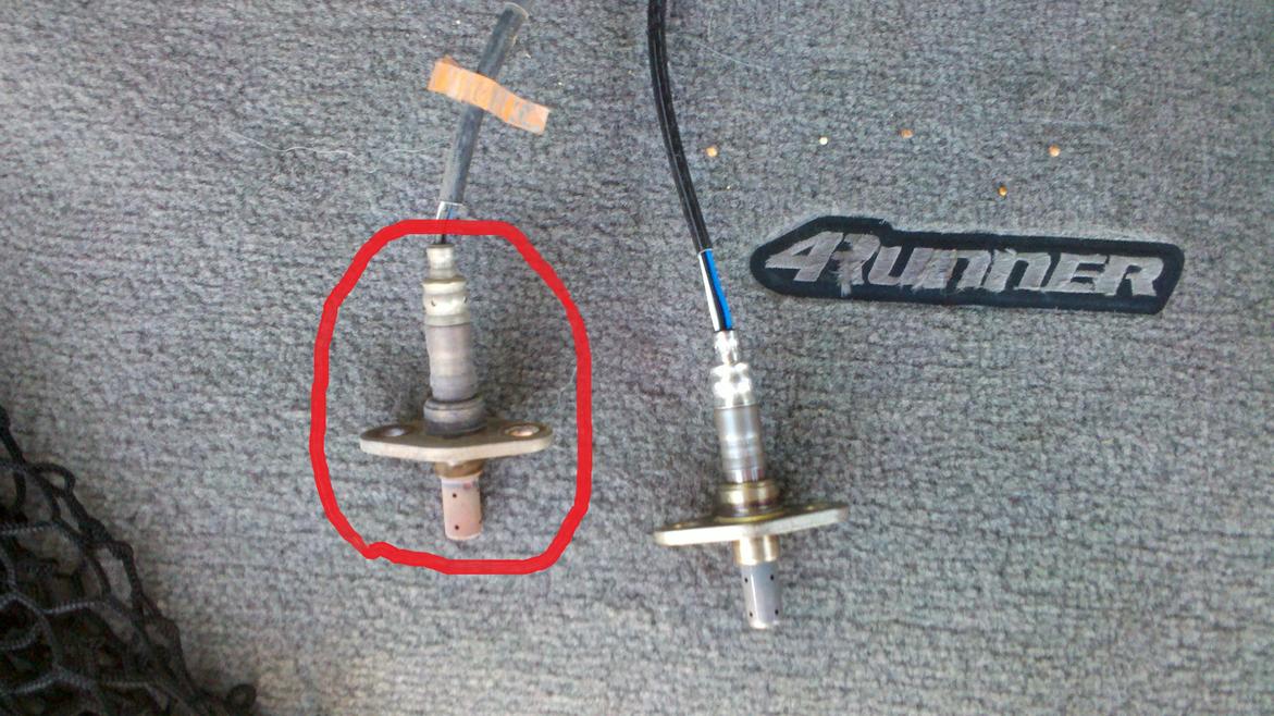

Could be this (the one circled in red/replaced with the newer one on the right).? Have you had the code checked yet?
