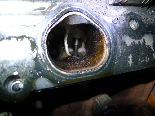

I don't want to fill your sleep with nightmares, but if/when you pull your spark plug to check it out; get a really bright flashlight and shine it down into your cylinder, you'll be looking for green. It's not terribly common, but the 5vz heads have been known to crack between the intake and exhaust valves around cyl 3 and 4 respectively. if you see green, you've got coolant in the combustion chamber and therefor have cracks or a head gasket failure. ..which will cause misfire.
If you exhaust your options up to injectors, pull the upper intake manifold first so you can get a better view down the intake ports to see if there is green. otherwise you'll spend $200+ on injectors when you could spend it elsewhere.

coolant on the back of the valve
i will look at this when i go to change them in a week, thankyou very much!!
