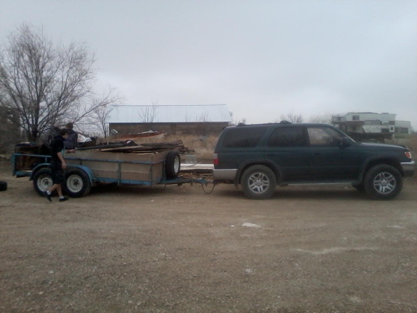

So bit of an odd issue.
This has happened twice both while towing.
Incident 1: Towing a 1500lb tent trailer on hwy. Floor it to pass semi. Check engine light comes on with no loss of power/hesitation etc. Code pulled 15 min later at autozone is P0133/ O2 sensor circuit slow response time. Reset code and never had issue again until...
Incident 2: around 1 year later (Towed a couple times between with no problem)
Towing a 3900lb load (2000lb trailer with 1900lbs of scrap/garbage from gpas shop)
Going up long steep hill to dump and check engine light comes on again. Finished load, took to shucks and get the same P0133 code. Reset it and has been fine since.
So why am I getting this? First time engine was N/A, second time supercharged.
Any ideas?
