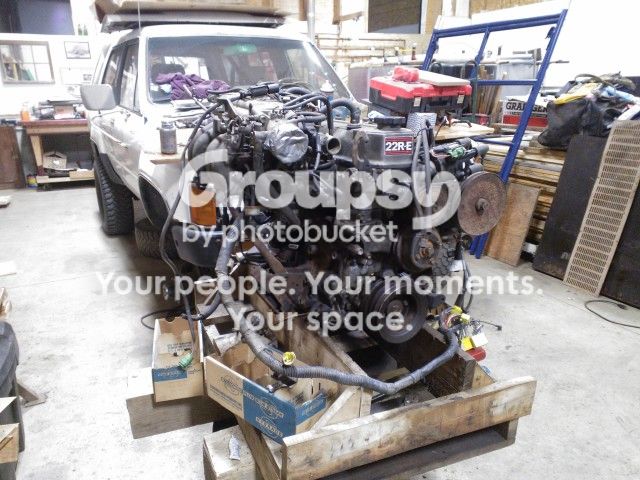

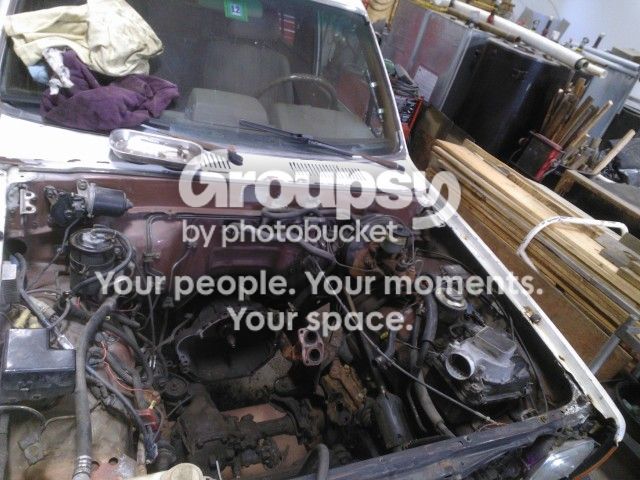

The ADD diff is locked in the On position and I kept it for the extra fluid capacity. Truck has Warn hubs on it, bought it that way. Originally had the Auto-hubs.

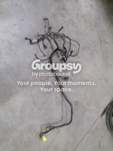

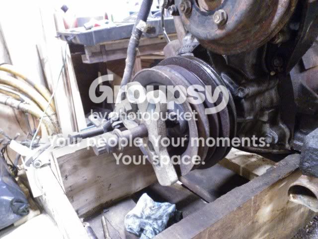

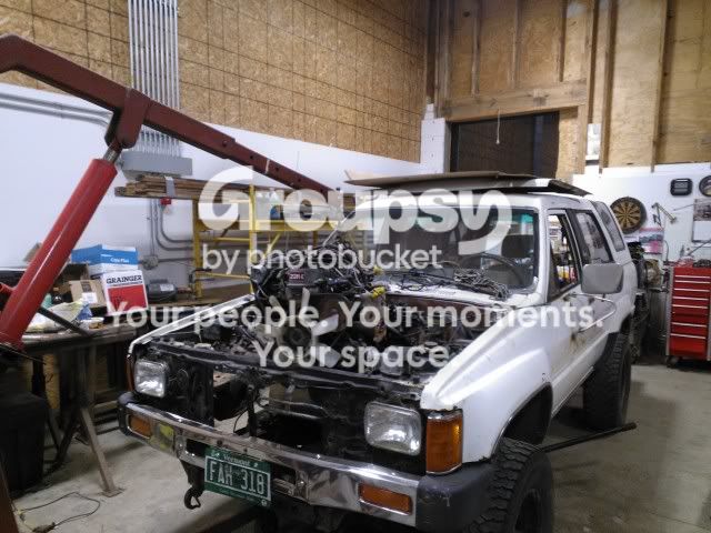

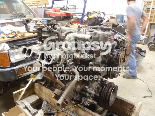

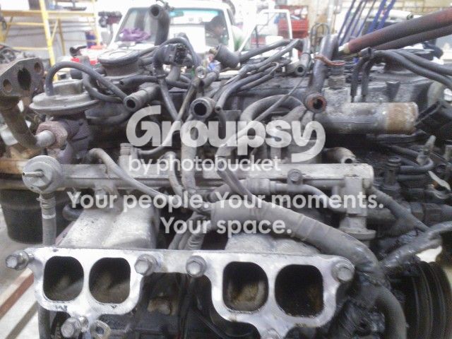

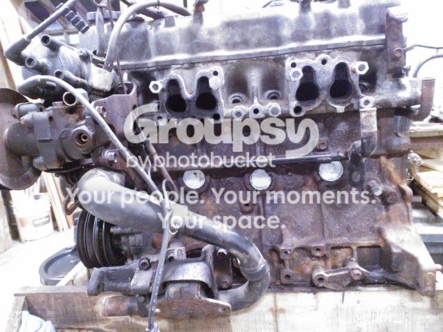

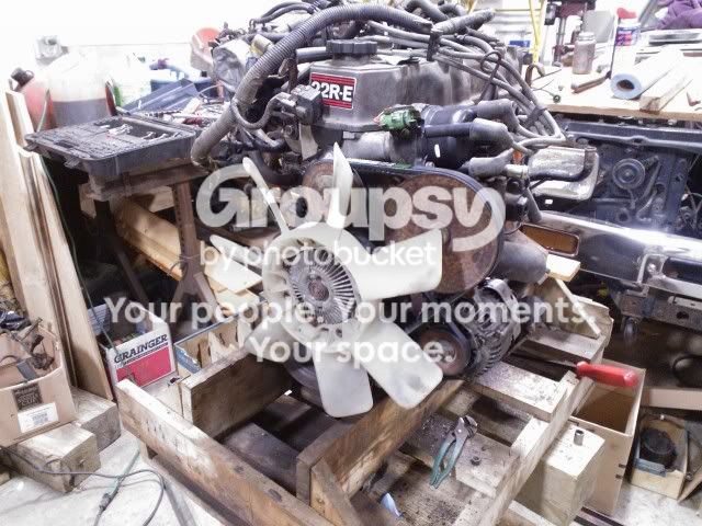

The motor on the hoist is the new motor, the one on the barrel (its sturdy, I swear) is the old one. The people who puller the donor motor were not careful and cut every/wire hose. So I stripped down the old motor once it was out and pulled the harness off of it.

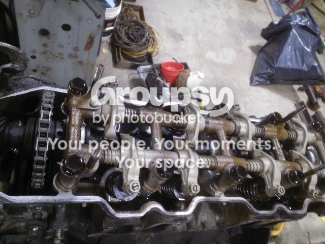

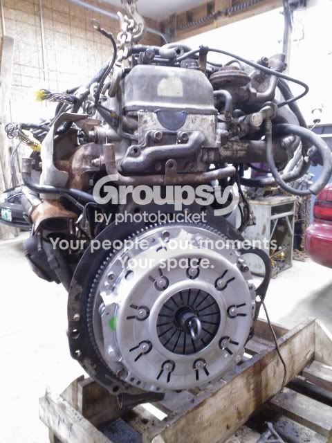

My clutch and flywheel were shot. I guess I need to learn how to drive.

More progress this week.

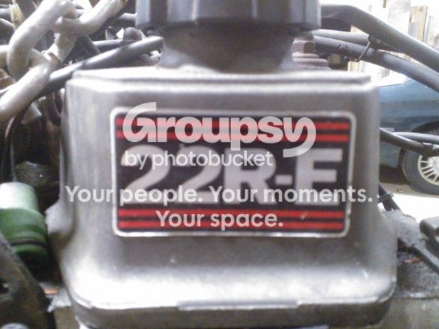

Ordering parts today .. Exhaust manifold and collector gasket, plenum gasket, thermostat, rear main seal, fuel and oil filter, clutch, flywheel, cap, rotor ( have good plug wires) Alt and fan belt
Timing Chains good
Anything else I should order? Motor had 68k on it.

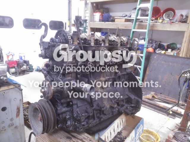

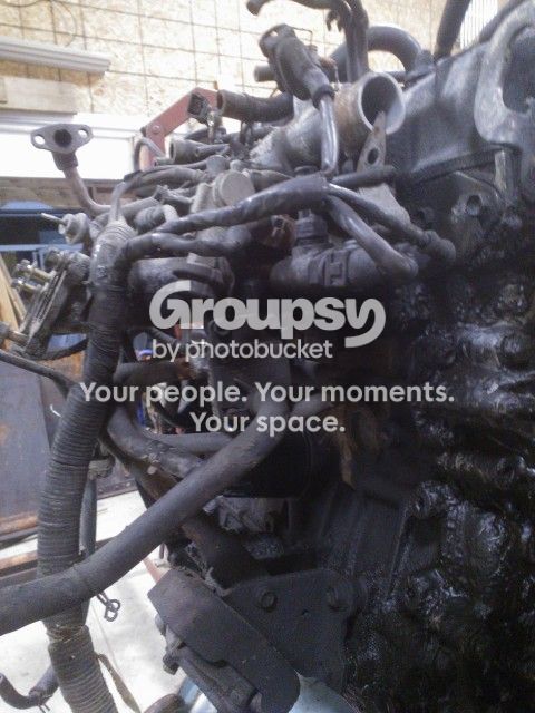

Now would be a good time to degrease the heck out of the engine and replace your oil and water pump. They are cheap and now is the easiest time to replace those parts. I would order a whole gasket kit from engnbldr.com and get your oil and water pump from them. Pull the TC cover and replace that gasket as well. You have a mess built up on the front of that engine and I would be concerned about where it's coming from unless you like to have engine fires at gas stations :D
That mess is the old motor, the valve cover gasket was leaking bad. New one is really clean. I dont have time to order anything, plan is to have the motor in by the weekend.

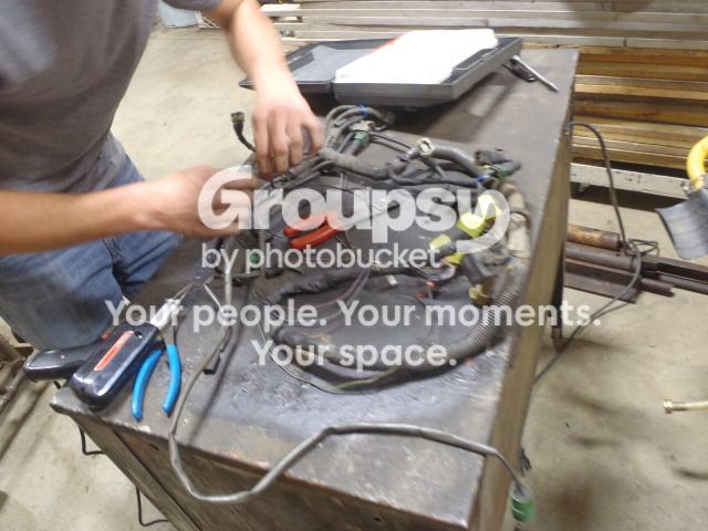

Got my wiring harness spliced together where the original wires were dry rotted.

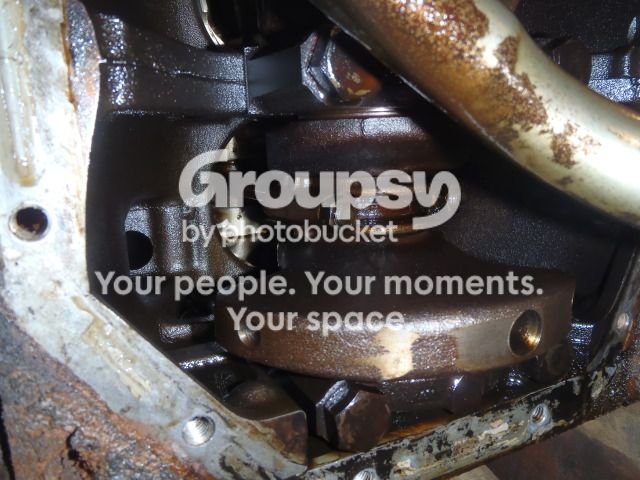

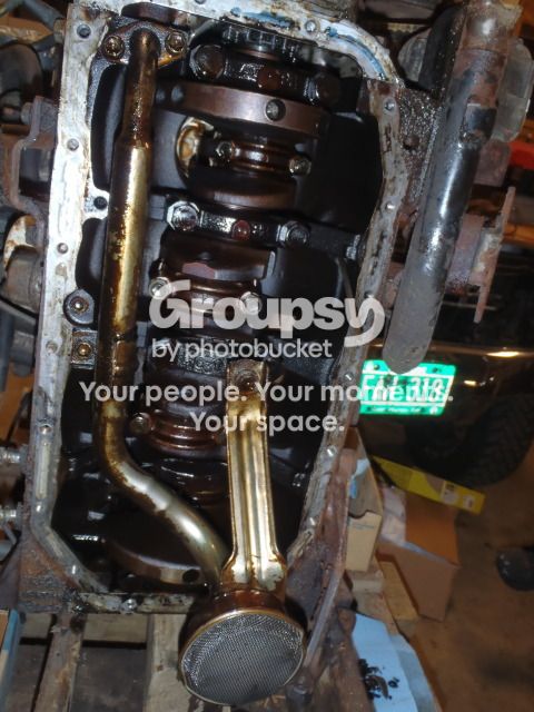

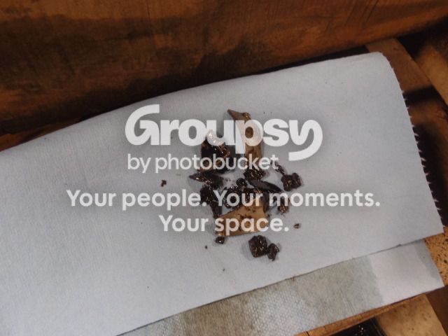

Then I flipped it on its back to pull the pan and this is what came out. :toilet:
PA031399.jpg~original
Cylinders all looked good, and there were bits of plastic on it and a different color sealant on the front part of the pan... Hmm.
PA031400.jpg~original
So we pulled the intake and the valve cover and to check the timing chain... and find a brand new timing chain.. score. So the old one exploded and they never drained the pan after the change.... :rant: huh.

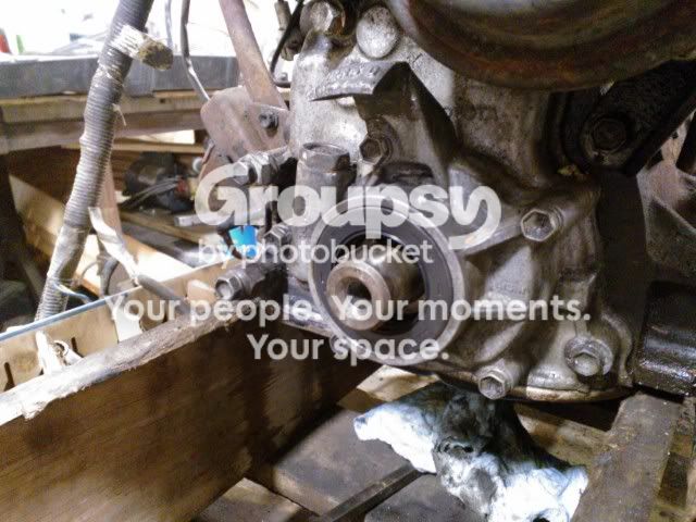

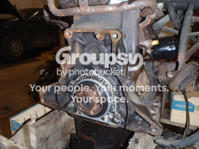

And changed the front main.
temporary-101.jpg~original
Front back together

And started dropping it in
temporary-108.jpg~original
Tranny and motor mounts are in... almost done.

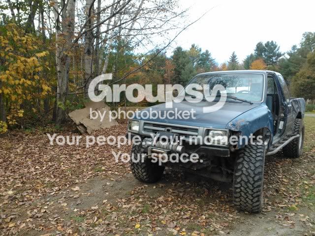

Unrelated to my motor swap.. But I did take one quick lap around the property before I left..

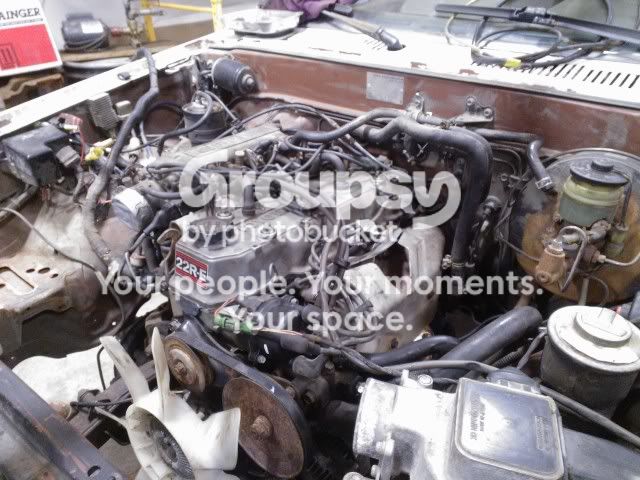

Got it running tonight!!
:party:
Still needs some tweaking and the valves are ticking pretty good. So Im gonna pull the valve cover to double chek them and hopefully do some wheelin on Sunday.
:bluejump:
Valve adjustment part duex. Much quieter now.
