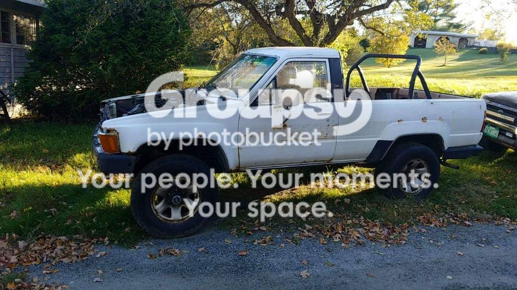

I found my old runner for sale about an hour away from me. The engine is out in the middle of an LCE upgrade, body is just sitting on the frame, and its a little rustier from sitting. But there is it. Poor thing. I offered him 800 but he didnt take it. I need a tow rig more than I need this project back. Haha.
