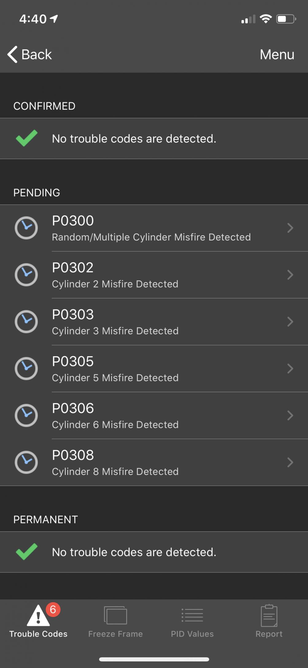

[MENTION=262938]gthoman[/MENTION] did you ever figure this out. This is exactly what’s happening to my 06 v8. Except there’s no solid check engine light. It blinks and I get pending p0300 for random cylinder misfire and a few other codes. Exact symptoms as you.
