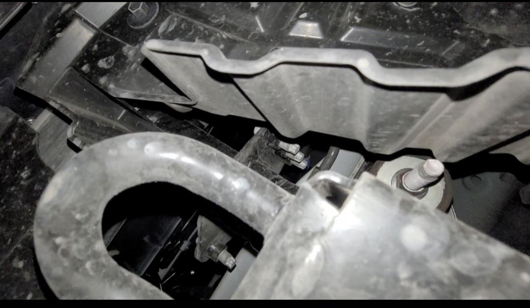

Here it is, excuse the screenshot, only way I could get the file size down

Looks like the cover over the oil drain plug. They didn’t tighten the two bolts properly. You’ve just experienced one of reasons why so many people avoid routine dealer service, and DIY or go to responsible independent mechanics.

Looks like the KDSS skid plate and that shouldn't cause those warning lights. Get gas recently? Gas cap loose?
The Nightshade is a version of the Limited. KDSS isn't available on the Limited.
The pics aren't great, but I agree with Electroboy, it looks like the oil pan drain plug access plate wasn't properly bolted back in place.

What's strange that hanging skid plate is nowhere near the engine, its near the running board. Also looking at the photo more it appears there is some additional damage under there?

The picture isn't great, but I do believe it is the access cover for the oil pan drain plug. It appears the bolt towards the driver's side fell out (or wasn't installed) and the bolt on the passenger side is loose enough that the access cover is hanging down and rotated towards the passenger side.
I don't see any obvious signs of other damage in the picture.

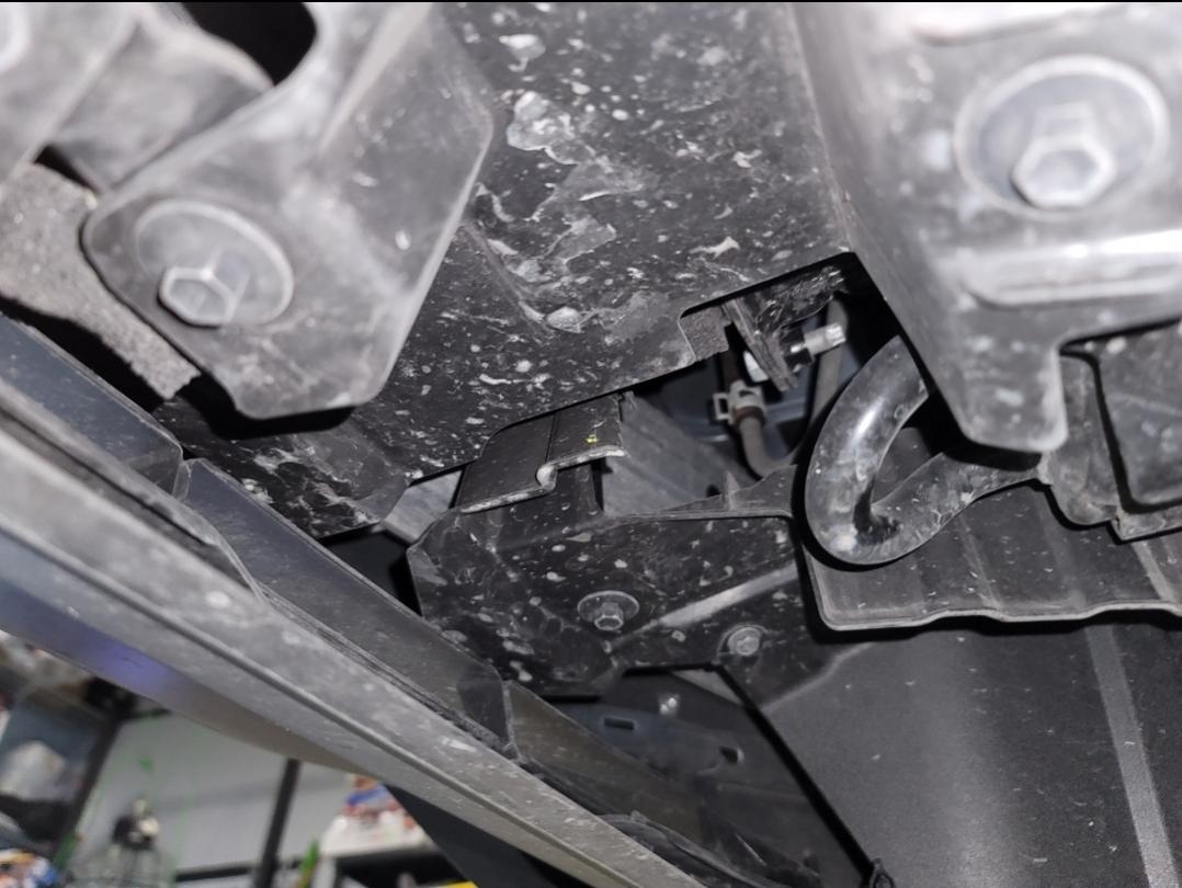

Got under the car and took some pictures last night, do these look right or should there be a cover on the bottom? Apologies for not the best pictures and thanks im advance.

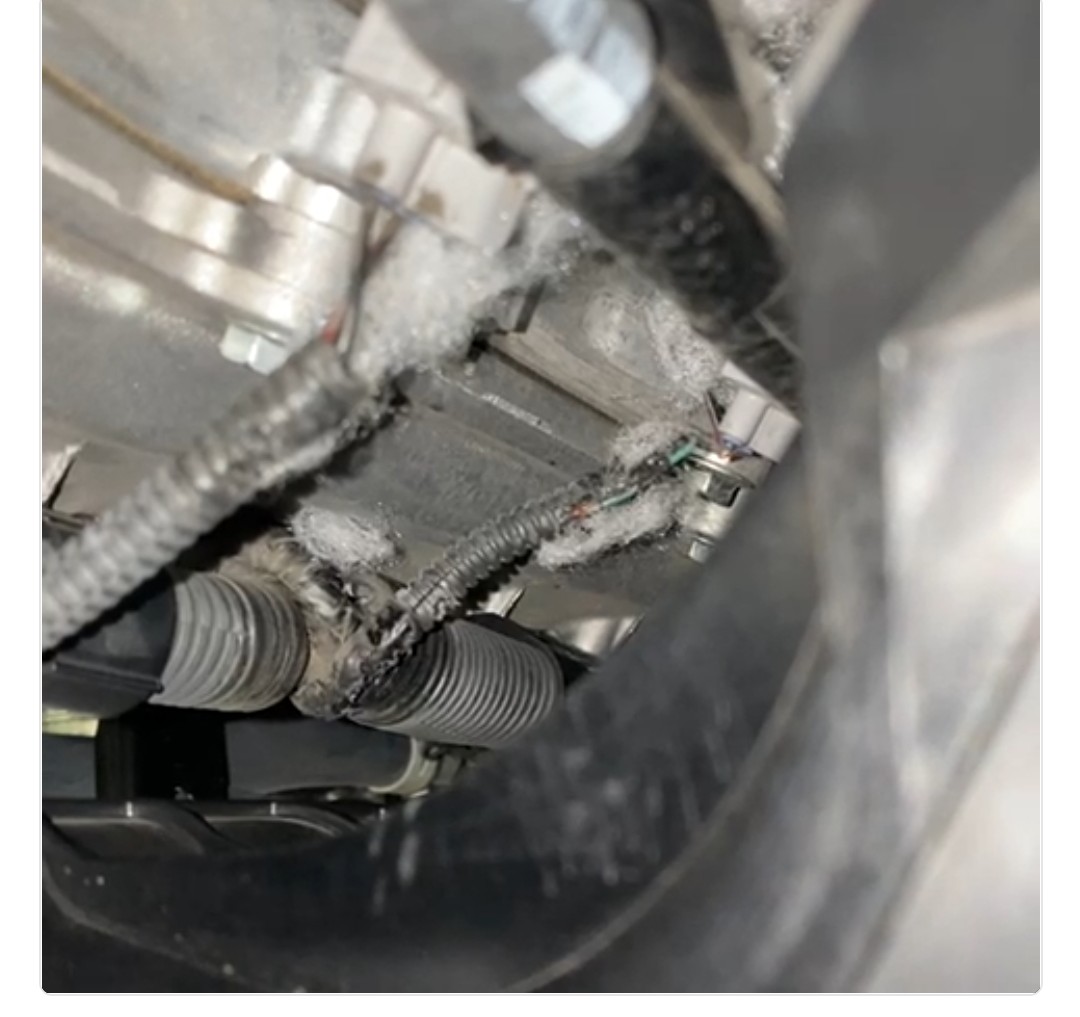

Well it was rodent damage. Apparently they chewed through the fuel injector harness, $980 to replace.

Exact same thing happened to me. Mice ate through two of my injector wires. Managed to have new injector clips splices in.
