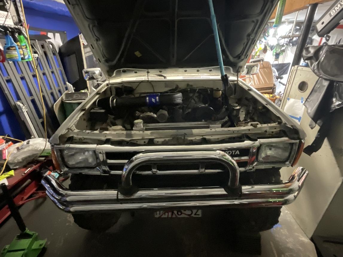

I ended up cutting the lines and putting in high pressure couplings in to get my steering to work with the 4.3 setup.
4.3l
