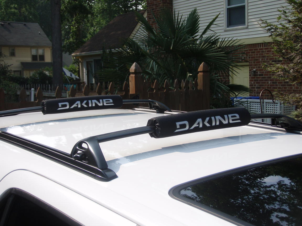

You can remove the torx bolts with no problem. The threaded inserts won't "fall" in. I assume they are tacked in place. As far as reinstalling, I used foam gasket material from a weatherproof electrical coverplate. I heated the head of a #8 framing nail with a lighter and "stamped" a hole in the gasket material. Did this 10 times roughly 1" apart. Then cut them into individual gaskets. Haven't had a leak yet. That said, I'm sure silicone would work as well. I did disassemble mine to paint and I'm pretty happy with how they turned out. Just curious as to how long the Rustoleum satin black will hold up over time. I sprayed 2 coats of primer and 3-4 coats of satin.
1996 Toyota 4runner 022.jpg (131.1 KB)
Sorry, don't know how to resize pics :shrug:
Thanks for the info, I think I'll just mask off the area around the rails.
