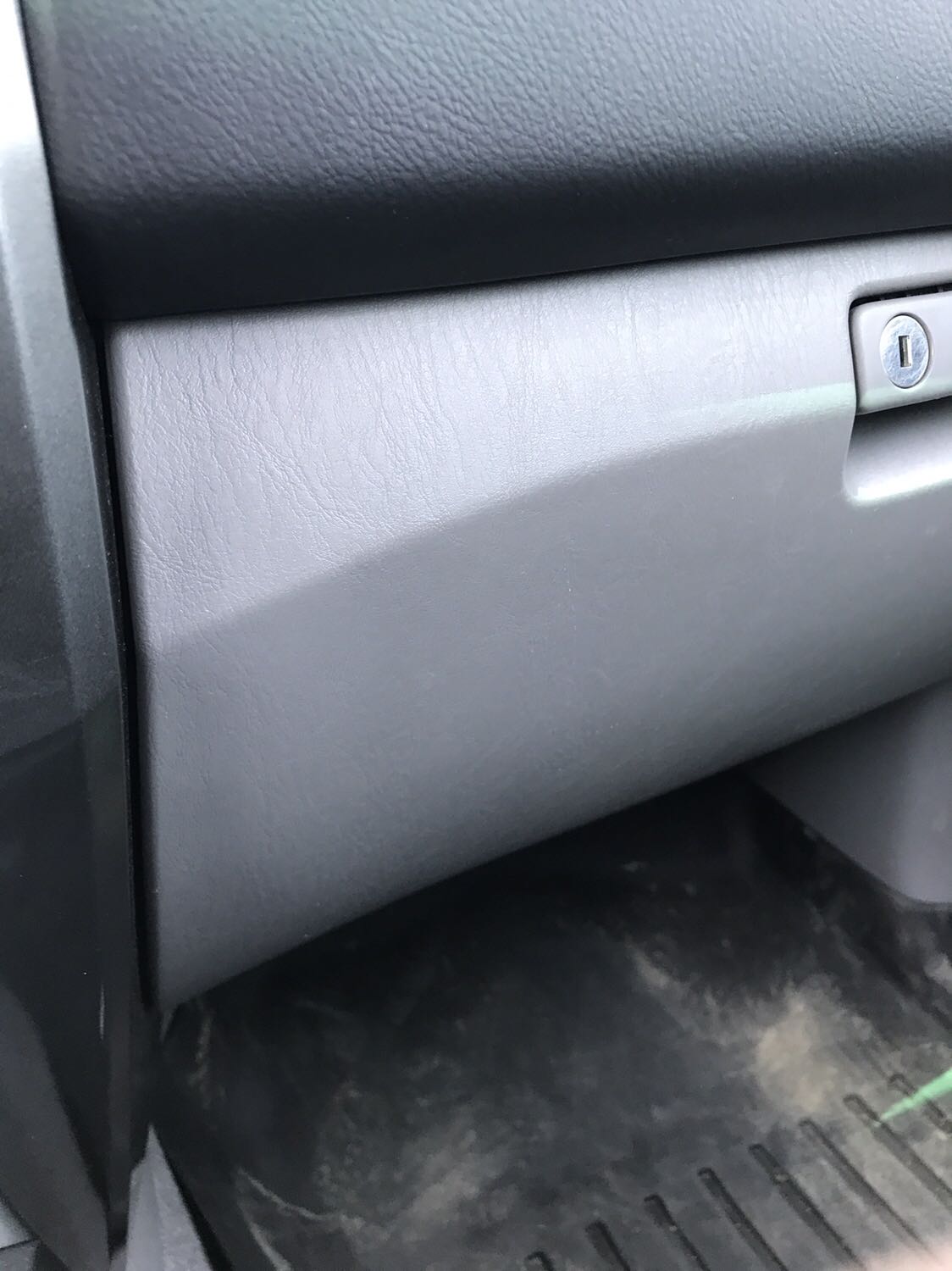

What is this noise? Sounds like a bird chirping behind my glove box.

Well it looks like the video didn't get uploaded.
