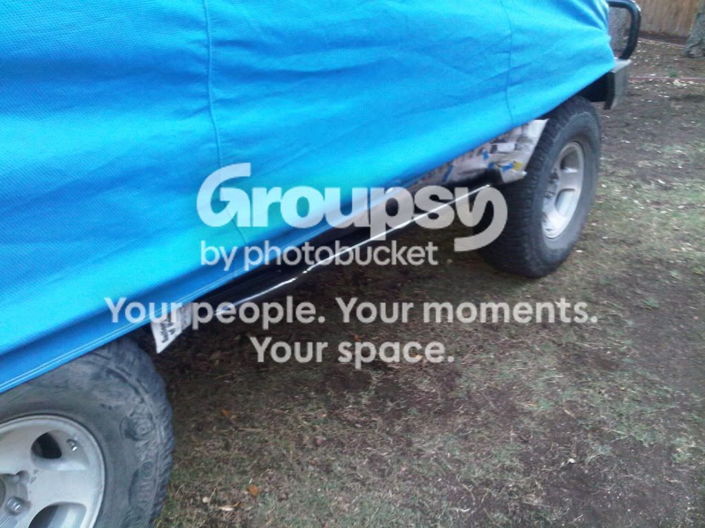

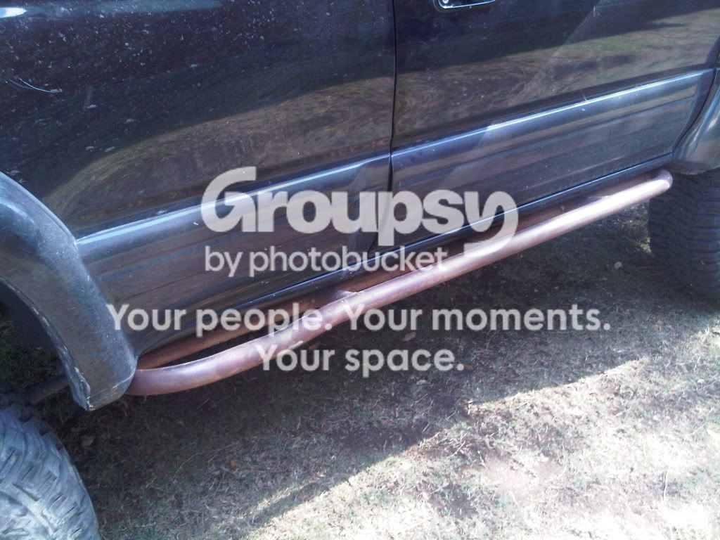

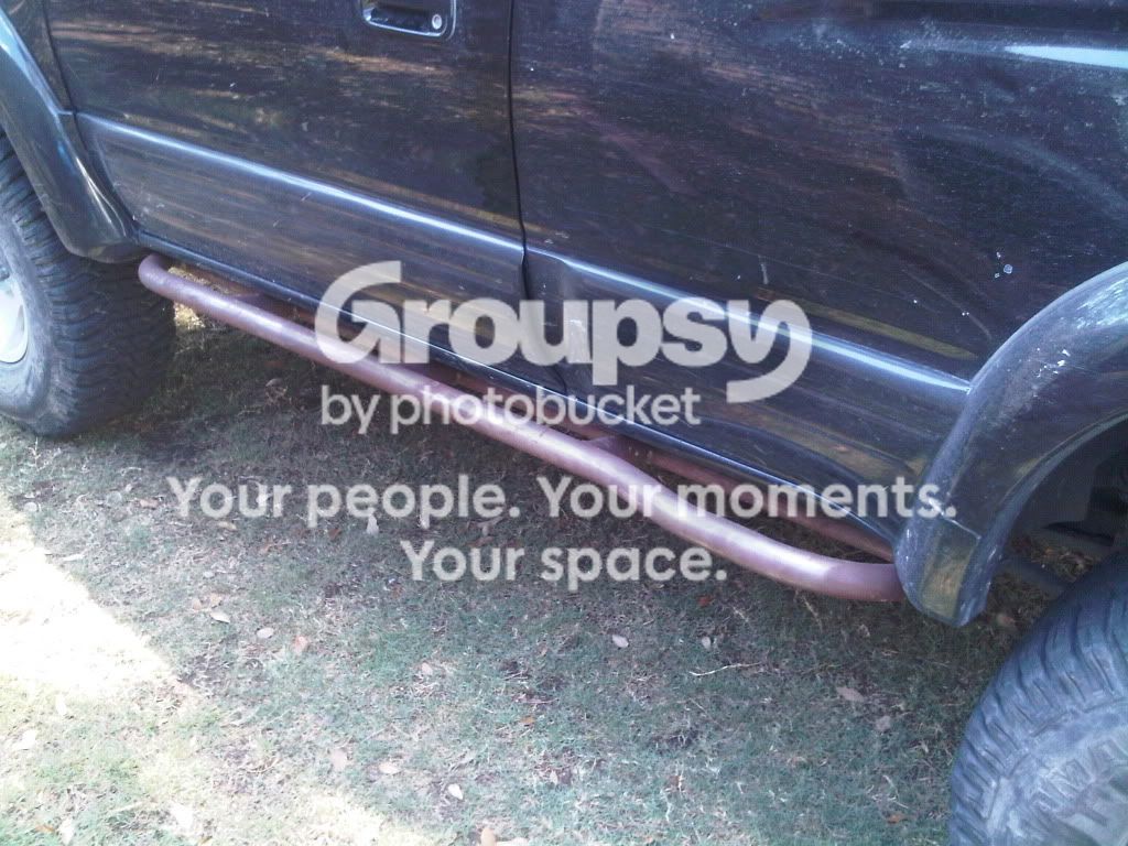

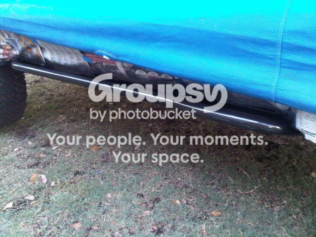

Got the sliderz painted today. Used a black rustoleum hammered metal paint. Here are some before and after pics:

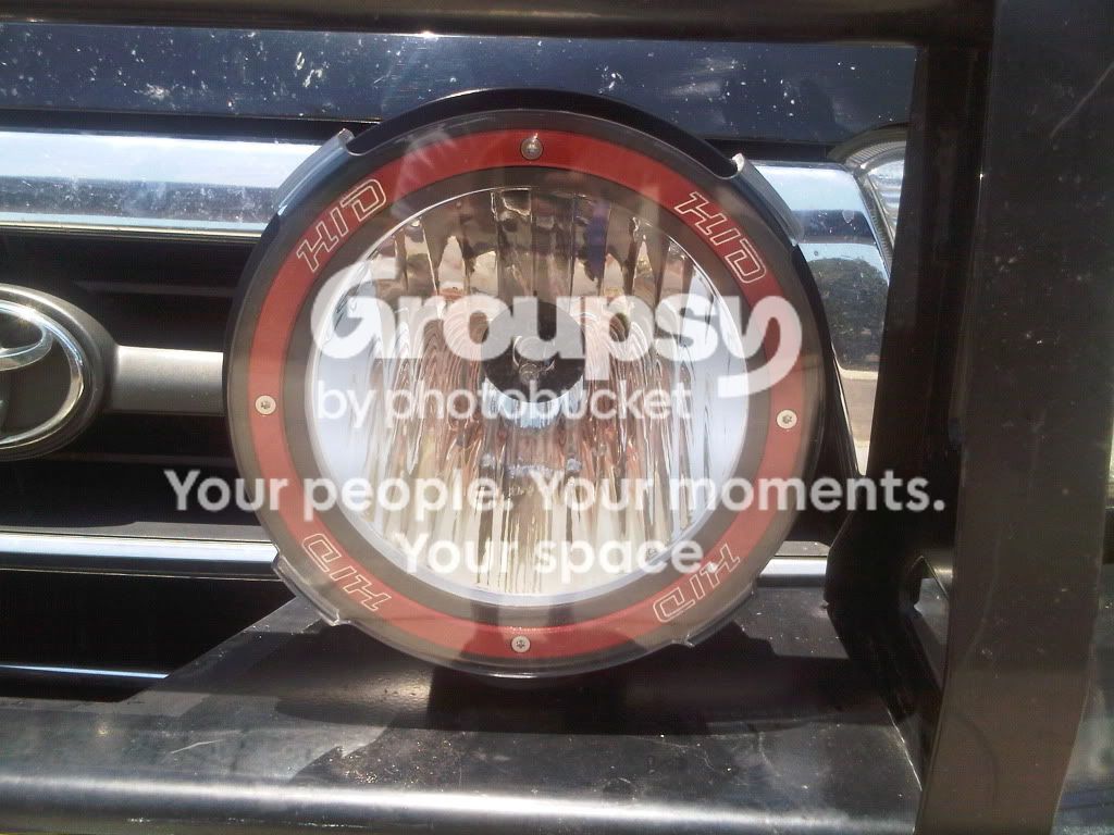

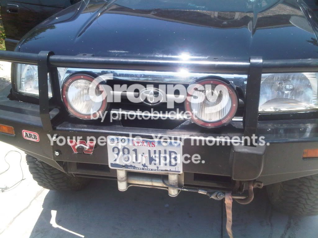

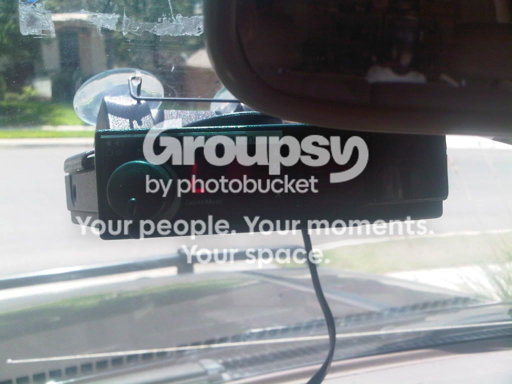

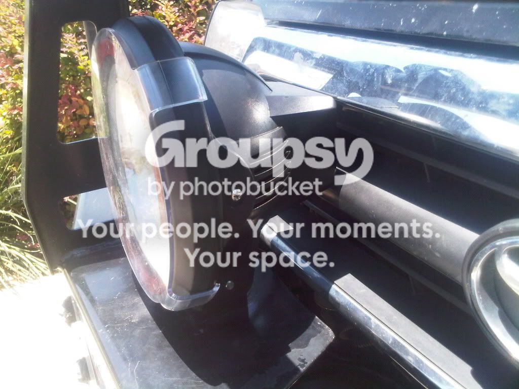

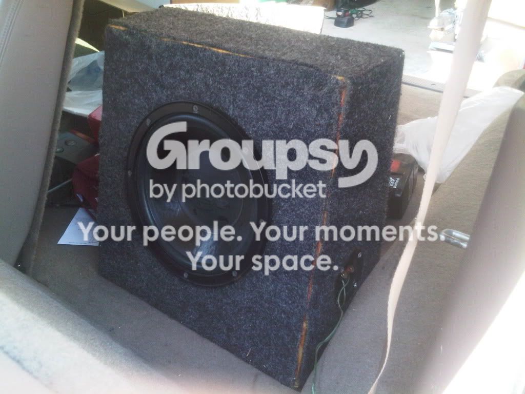

Got a few upgrades done yesterday and today:
Valentine One, 2 Kragen 7" HID Spotlights, Kenwood KDC-X395 headunit, MTX 10" sub, and rewired my rear speakers. Sound system sounds so much better with the new headunit and subs. Really ties together well with the Memphis speakers. The lights are also super bright. Will get some nighttime shots.

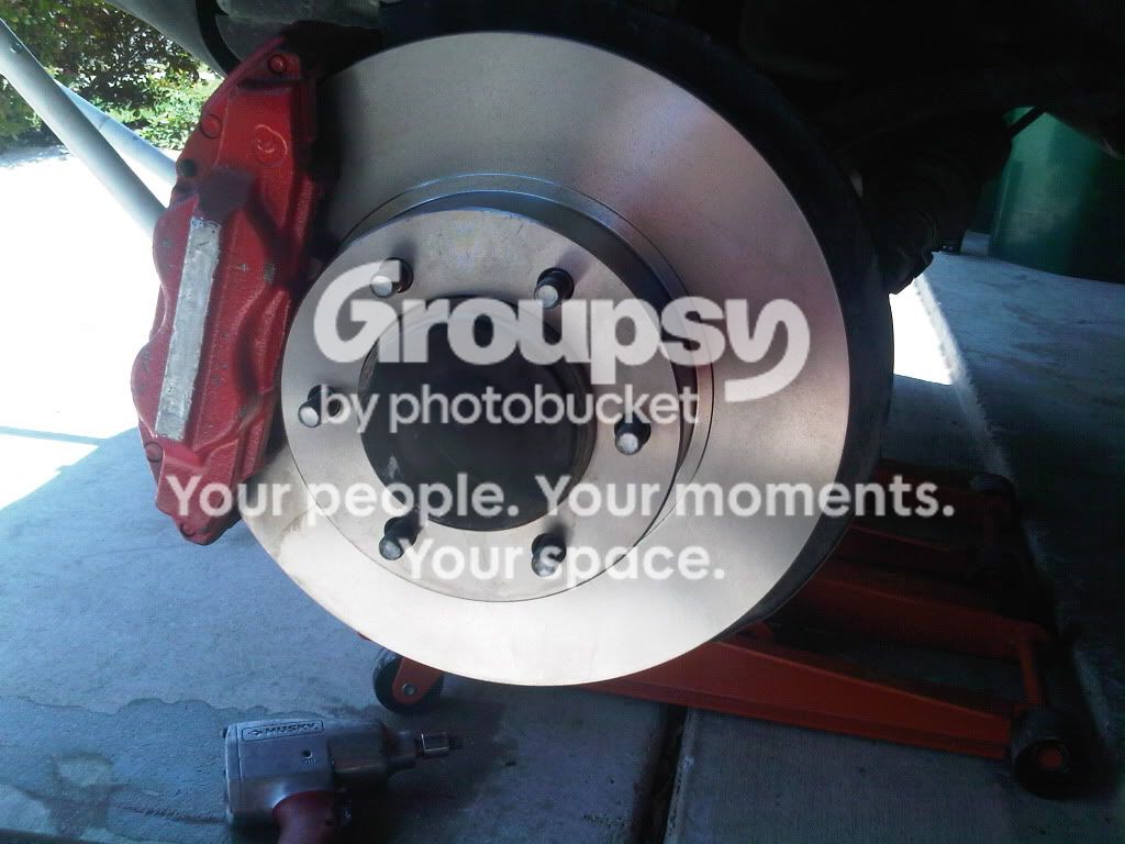

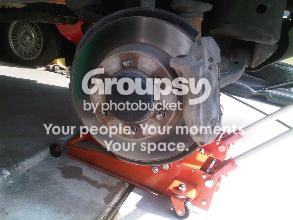

How hard was it to get the 231's to clear the LC80 wheels. I am going to get mine to fit tomorrow hopefully.
I trimmed the edge of the caliper with a dremel then let the wheels take care of the rest of the trimming lol. They still growl a little but so I think I might throw a small wheel spacer on the front tomorrow.
majorly sketchy dude...grind some more down, do it right :thumb3:
Eh not really a huge deal I think. I've read lots of other people doing similar when mounting their Tundra brakes. The metal on the calipers is pretty soft compared to the wheel. I just drove around the block once and the noise was basically all gone. Only makes a little bit of contact noise when backing up slowly.

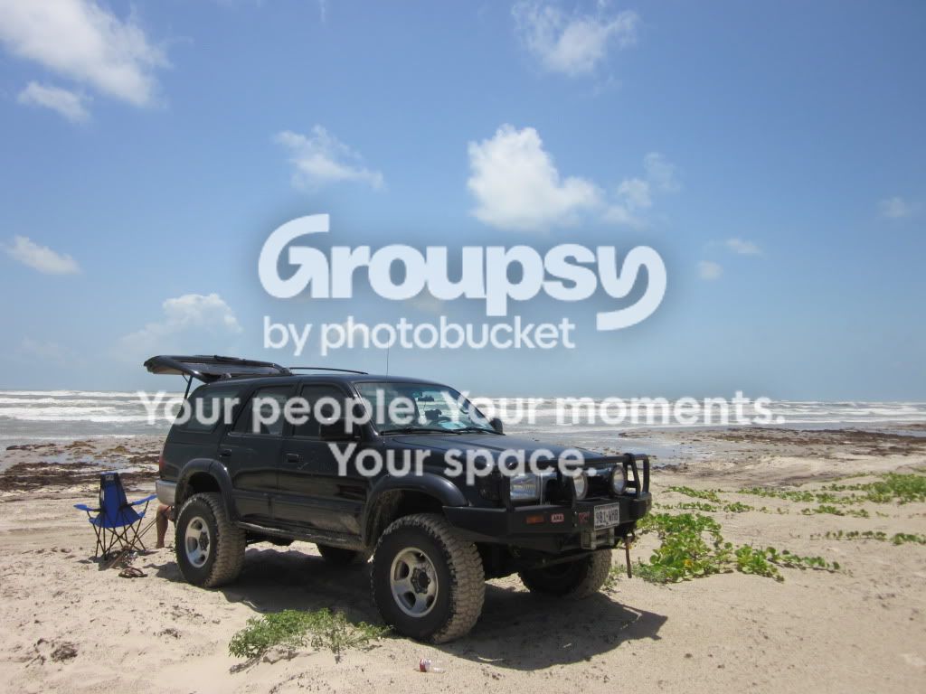

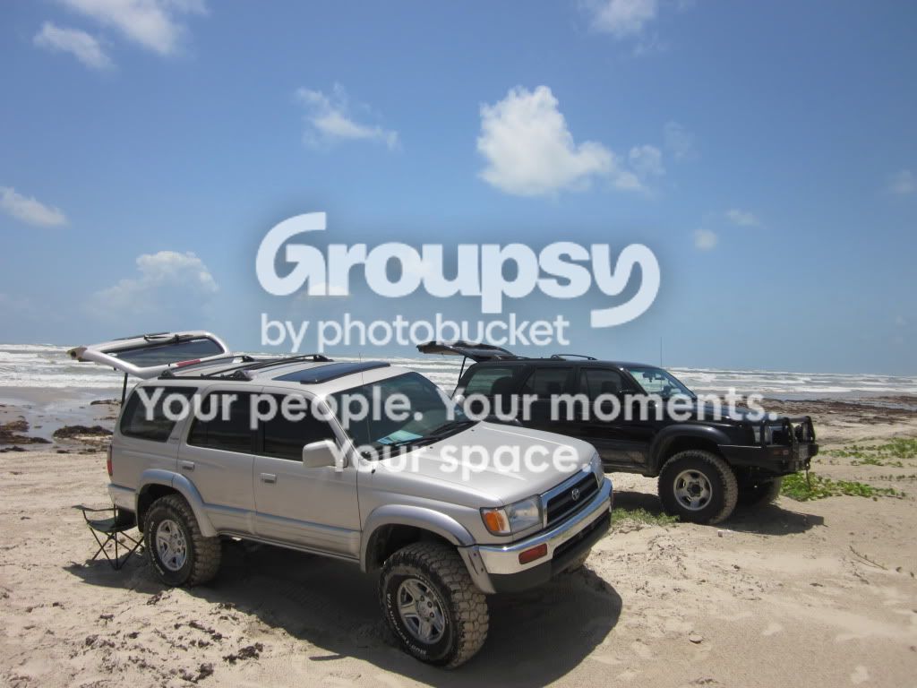

Went to the Padre Island National Seashore today. Was there with my girlfriend, Dalton (trailmix), and his girlfriend. Beach wasn't in the best of conditions but still had a good time. Tide was way up so had to drive through some water to get to where we wanted to be. Here are some poser pics!

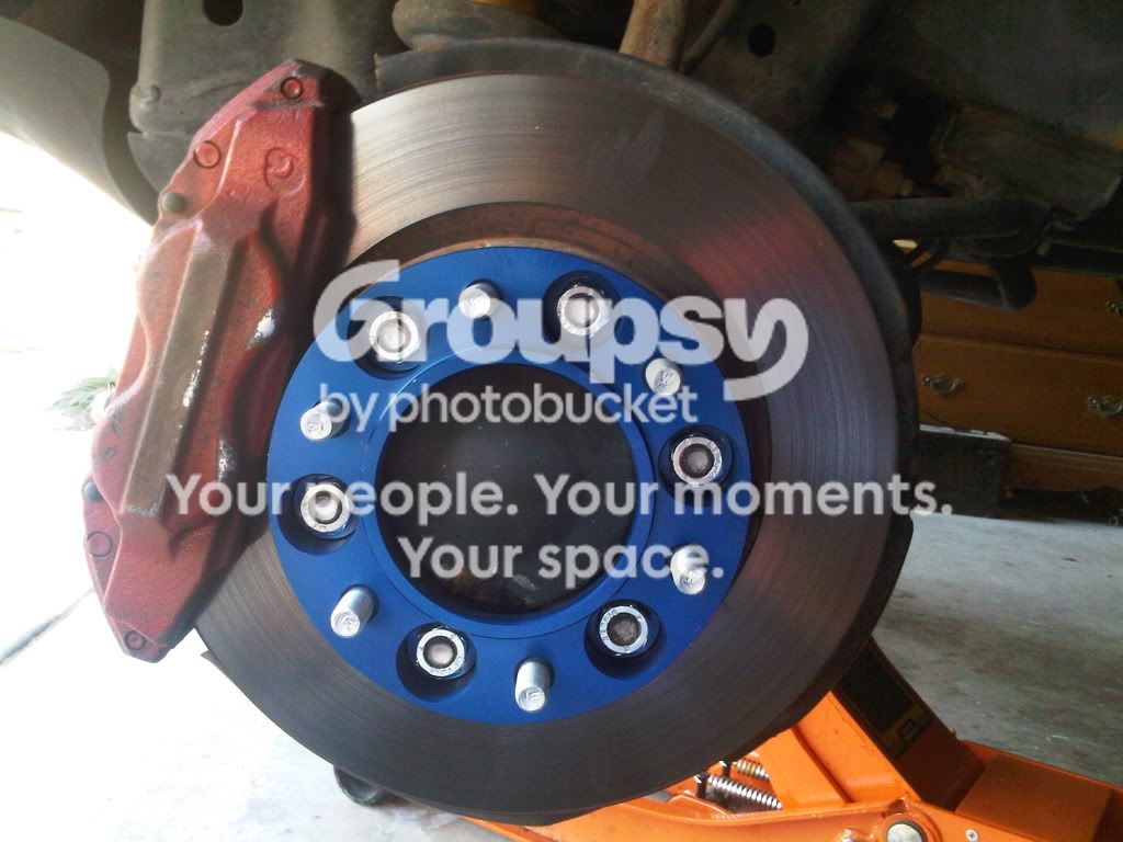

Finally got around to installing my Spidertrax 1.25" wheel spacers. Now my brakes don't rub the wheels, but now my tire rubs on the inner fender! Argh! Guess I'm going to have to bust out the grinder.
IMG00615-20110721-1908.jpg~original
BEFORE:
IMG00616-20110721-1912.jpg~original
AFTER:
IMG00617-20110721-1912.jpg~original
