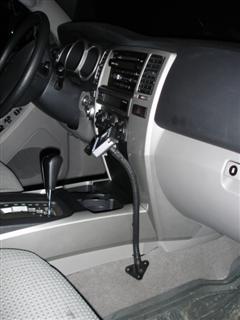

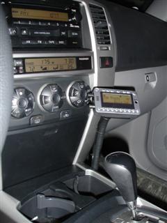

Where did you mount your Roady2?
I went to a Verizon Wireless store and got a goose neck to mount it to. Here are a few pict's.
