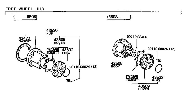

It's easy to rebuild, all you need is an O-Ring, two gaskets, and some grease.
Dial Gasket 43531-60010
O-Ring 43532-60010
Hub Gasket 43422-60010
