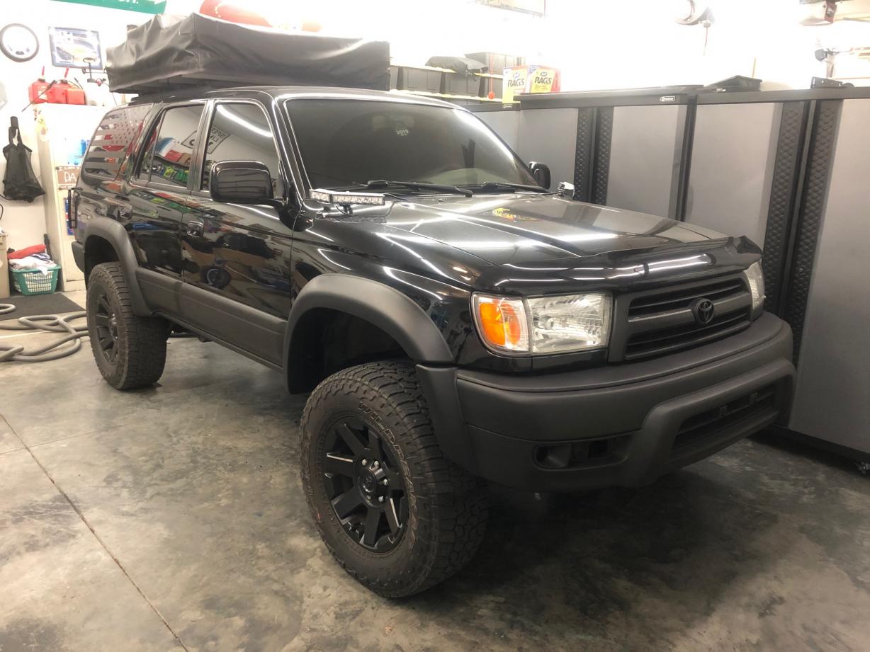

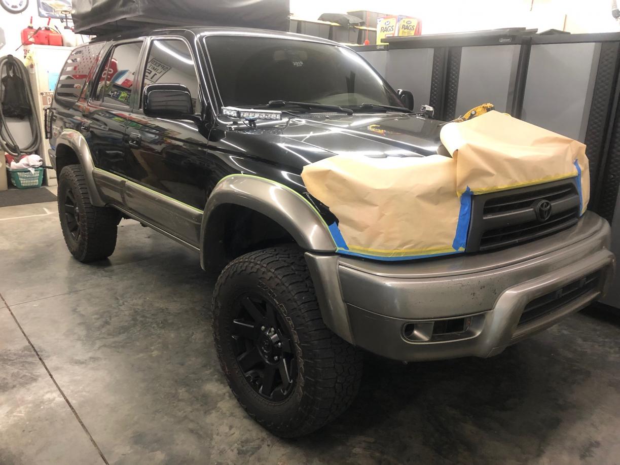

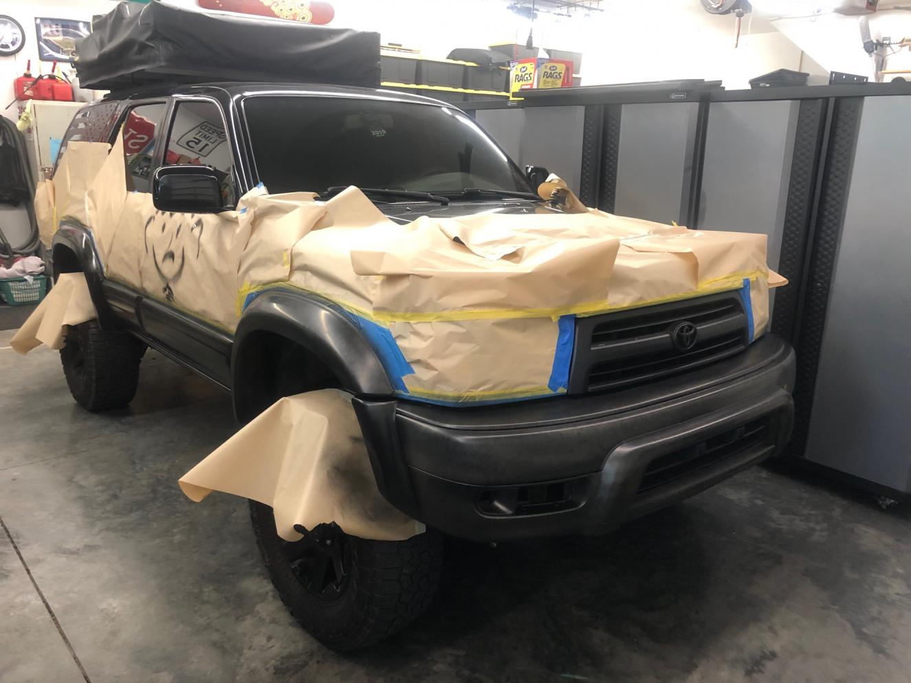

I have to disagree with number 3. Well half of it.
Does it look good, yes
Will it last. No. Especially in the door sill areas. But I will be adding those vinyl door sill protectors to take care of that.
It was nice to see what it would look like all black. Took 4-5 cans of plasti dip. About a can per coat. Just don’t try and cover on the first coat. The first coat should be light. Just enough to bond to the plastic cladding. Then build up the coverage with each coat from there.

You did a good job sir! Looks pretty solid. with the matte/gloss black combo. vader.
