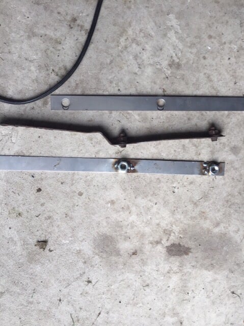

I made new nut holders out of stainless and welded nuts to them.
I cut 4 strips, two for the puppy hauler and two for my SR5 project. Used the old one I cut the bolt heads off of the locate the holes and punched the holes in and then clamped the old and new together with what was left of the bolt sticking through the holes and set a nut over it and welded it. Between liberal use of antize and the stainless holders if it ever has to come off again it should be much easier.
