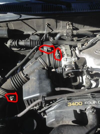

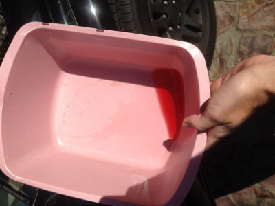

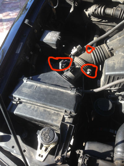

I'm mechanically illiterate and it seems like everytime i touch my engine i break something... somehow, after cleaning my MAF and attempting to clean my TB but giving up (running out of daylight) my car now leaks what looks to be ATF fluid (EDIT: it is coolant.) I have done the trans cooler bypass if that makes any difference and it wasn't leaking before this. I'm not sure how the two can be related but i tightened a few of the clamps near the TB because they were so loose that they werent even doing anything. i tightened or adjusted the red circled parts (didn't touch the transmission fluid lines to my knowledge) and the bucket shows how much fluid has been leaked in about 10 hours. I'll probably take it in to the mechanic tomorrow unless anyone has any suggestions... thanks in advance

Nothing you've circled is related to trans fluid so you probably didn't cause it by cleaning the maf. perhaps you should check your work bypassing the trans cooler? Just see if you can find where it's coming from. How long ago did you do the tranny cooler? I assume you closed off the old radiator lines?
Red Toyota coolant from the coolant hoses going into the IAC valve on the TB possibly?
My thought exactly. Although most on here would not confuse coolant and ATF...
...really depends on where it is leaking from...not what you did just prior. Post hoc ergo propter hoc is a known fallacy.

It has been over a year since I installed it... and i had to take it in once already due to it leaking - mechanic fixed it. Glad that the two are highly unlikely to be related. Yes, old radiator lines were closed off as instructed in the tutorial on this site.

I can't find where it is leaking... I dont know the difference between coolant and ATF - and i am CERTAINLY not as mechanically-inclined as most on this board.

Well, ATF is red colored oil and coolant is red-colored water and ethylene glycol. Is it watery or oily? If it is coolant, it likely leaks only under pressure and you will only find the leak using a pressure testing kit.

It is definitely watery so i guess it is coolant... thanks for the help, i'll bring it in and hopefully it's not too costly of a repair

Look at every hose attached to your TB/IAC. And behind the manifold. Usually when I re-attached mine some hoses fall off, and I have to double check them.
It may sound weird, but does it smell bad? Transmission fluid has a very distinct odor, while coolant has a much more mild smell. That will help narrow down what exactly is leaking.

Not sure if you already found your leak yet or not, but coolant when it dries will leave a white, crusty film on the leaking components. Since you know the general area of where it is leaking from (since you caught in a bucket), go under your truck and look for the leak. Should be the only thing wet or crusty. Follow that up to the affected hose and you've found your leak.
The mechanic said the coolant leak is coming from the water pump... nooooo! So after all of that, it appears to be unrelated to what i did... Post hoc ergo propter hoc
