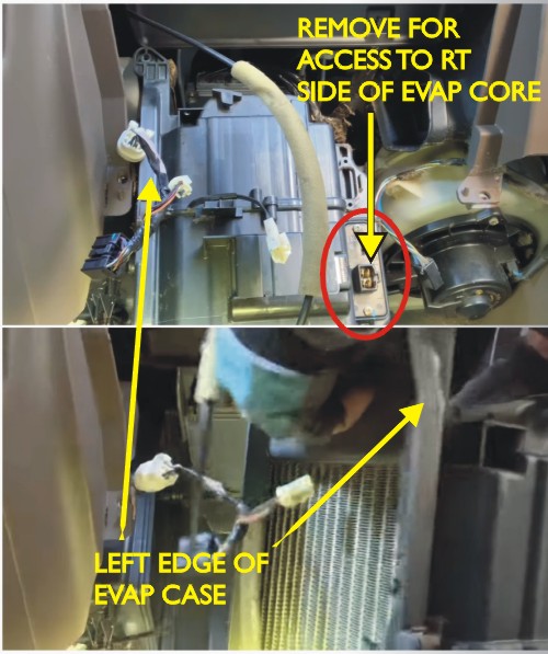

No idea. It's a screen cap from here. I wanted to show the core.

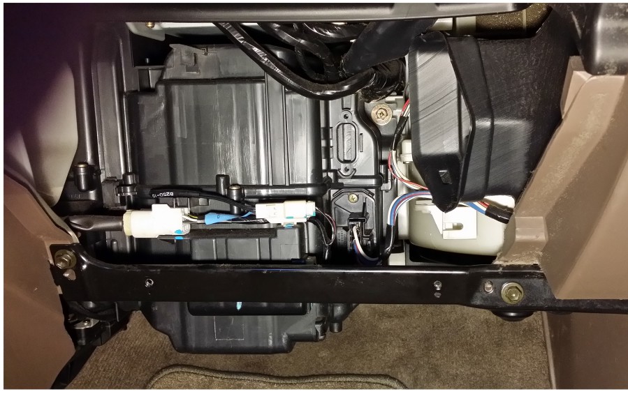

This is mine.
