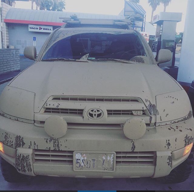

I think mud dries at highway speeds before you can get home or to the car wash. I get a lot of dirt and fine dust here on the other side of the continent. I usually hose the outside and undercarriage over my gravel driveway as well as I can before driving a couple of miles to the coin-op self serve car wash that has a power sprayer. If I'm cleaning the engine area I look for all of the electrical components, fuse boxes, alternator, etc and clean them carefully with a sponge and bucket first. Then I cover them up with plastic bags when I get to the power sprayer. I wish I could let it cool before washing or let it dry before leaving but that isn't practical for my methods. :washing:
The area I can never get clean is the back spoiler. Several weeks after my last dirt road trip it's still dripping dirt on the bumper. Everyone says that's normal.
