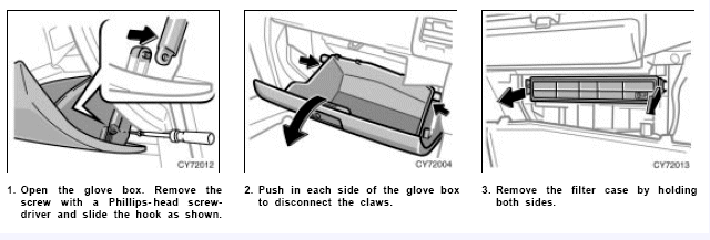

This should help.

Is it really that simple?
Any suggestions on how to actually clean the filter, or do you need to replace it.
Can you wash it with warm water and soap, or hit it with some high air pressure?
O'Reilly Auto Parts sells a direct replacement for 7.99. I buy them two at a time and change it every 6 months.
Make sure you follow step one to the "T". Remove the screw and physically separate the valve from the glovebox before pulling it down - otherwise you risk damage to the plastic TOP support where the little valve connects to - and that seems like part of the dash.

Yeah using filters made for home systems cut into 4 car sized filters really is the best way to go.
If you want to get a little more life out of your filter then you can blow a lot of the junk out using an air compressor... build up the pressure to a solid 150 psi or so and let it fly. Just make sure to do it outside. I do the same thing to my car air filters as well... only once about half way through their normal life span.
What were the dimensions of the filter that you bought that got you 4 filters?
Take yours out of your car, measure it, and then go to Wally World.....or wherever and do the math.
You are going to be really surprised of what will be in your old filter......YUK
