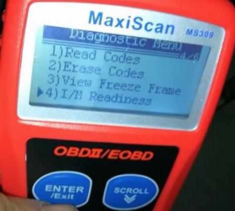

I got a cheapo $17 one online to check for smog data readiness and to read and clear CEL codes. No good reason not to have at least one of those. I have a fancier dedicated unit but I can loan this out to friends and not give a damn what happens to it.
