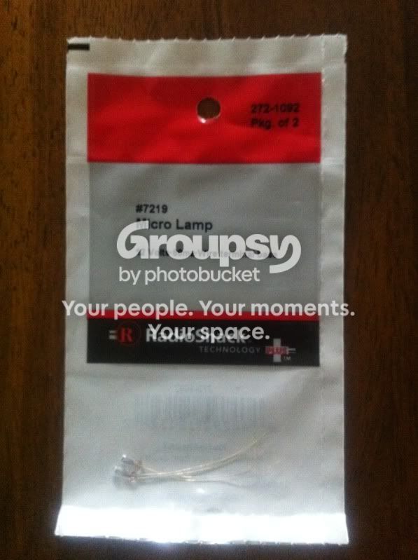

Thanks guys. I got 6 bulbs from Radio Shack, replaced the 3 that were out in 15 minutes. Now I have spares. Awesome.
Do you have part/item numbers for the radio shack replacement bulbs?
RS Part number 272-1092

I had my dash apart last summer and replaced all the lights with the Radio Shack bulbs. I got tired of two things:
1) Paying the dealer $3.50 - $5.00 a bulb
2) The bulbs never being in stock at the dealer and having to go back twice.
Nice job!!
The bulbs are clear. There is a little green rubber nipple that goes over the bulb. I actually have no idea what makes them look orange when they are lit up.
Interesting, I thought they were brighter.
I can confirm that they are indeed much less bright than the stock ones. I swapped out the one that went bad and the difference was quite drastic. If you swap one out, you must do the other one as well so they match. For me it was a problem because one of the two radio shack bulbs that came in the pack was DOA. I think I will go back to the shack and try to find something a little brighter. They have quite the selection.
