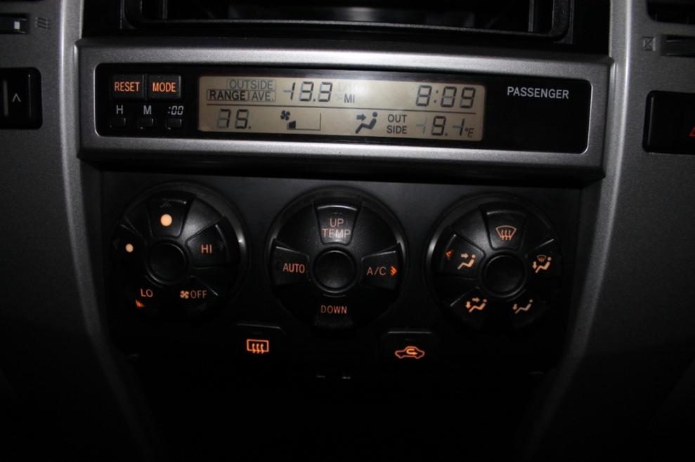

I’ve had LED bulbs in my climate control for 8 yrs, most of them are busted, so I decided to go back to OEM look, I purchased bulbs/microlamps from radioshack , they are the very the same bulbs I used as replacement 10 yrs ago. These are just bulbs and does not come with socket, I have to manually insert them in the socket that goes to the climate control module pcb. Now when I put them back on, all bulbs did lit up as expected, but the LCD display is messed up, I can see some background and overlapping texts. Everything is functioning, its just the display text aren’t legible.
I tried removing the bulbs but no luck, same problem.
Pic attached …thanks

I don't think it's related to the bulbs. I've changed our bulbs as you did with the radio shack lamps. No problem. Perhaps recheck the connections behind the panel.
