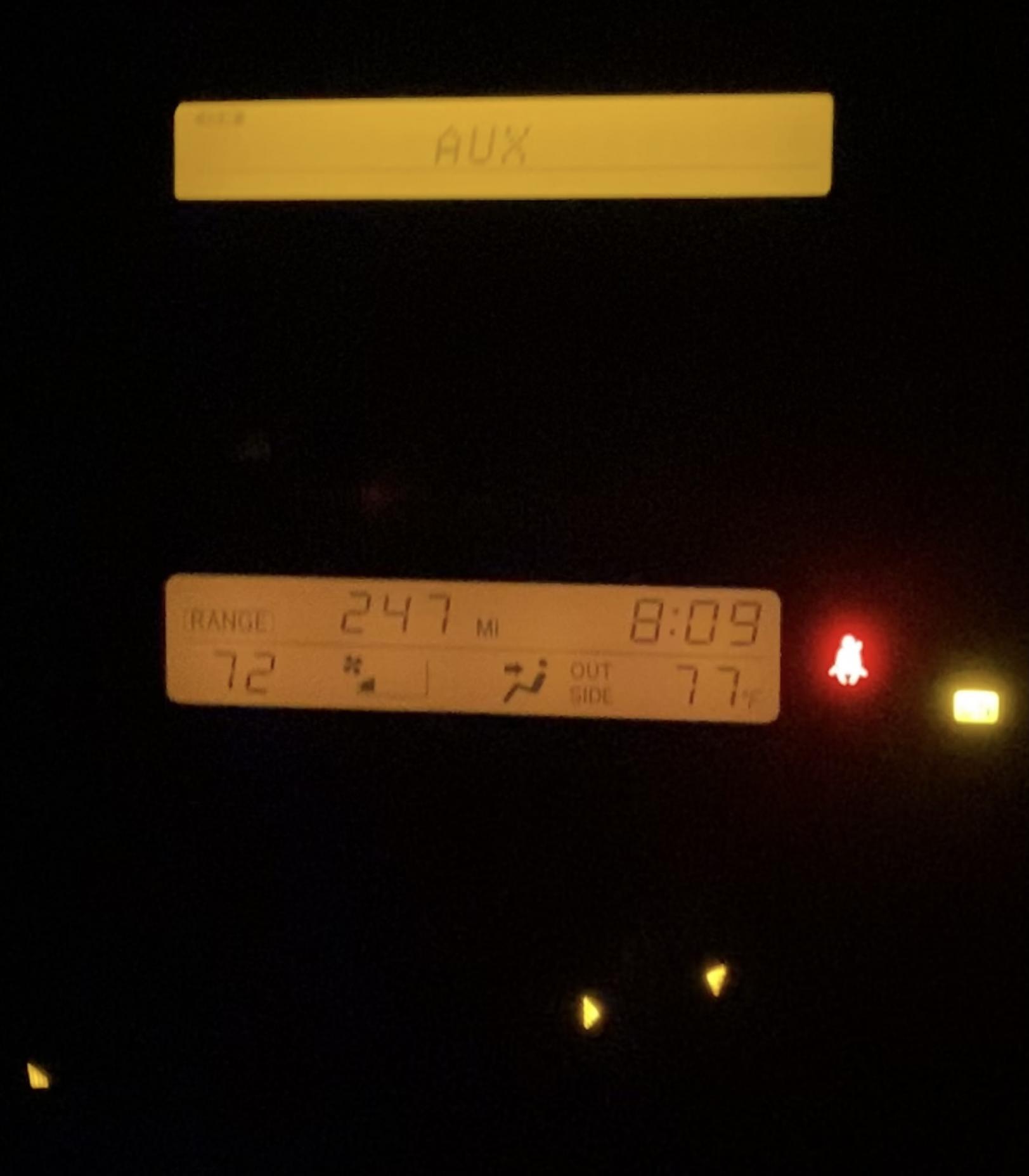

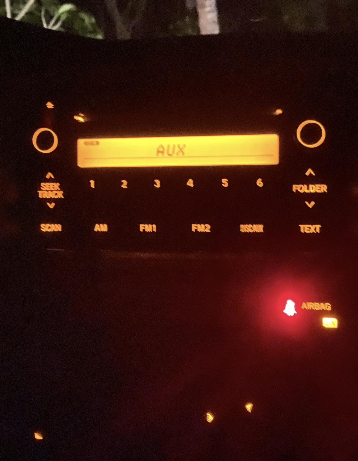

I have the exact same problem as OP. I will attach images of the headlights off with both lcd screens backlit, and headlights on with only the radio backlit. LCDs are backlit during the day and off at night and the button lights won’t illuminate where the text is. I just replaced all the bulbs and this is how it works. Before replacing the bulbs the climate control lcd would never have backlighting. The first image is headlights off, the second is headlights on. Please send help for this very real issue
UPDATE SOLVED: I found that the dimmer switch for the days lights was disconnected. I reconnected it and everything works! I imagine if this is happening to anyone that the dimmer switch could be broken/disconnected. Hope this helps
