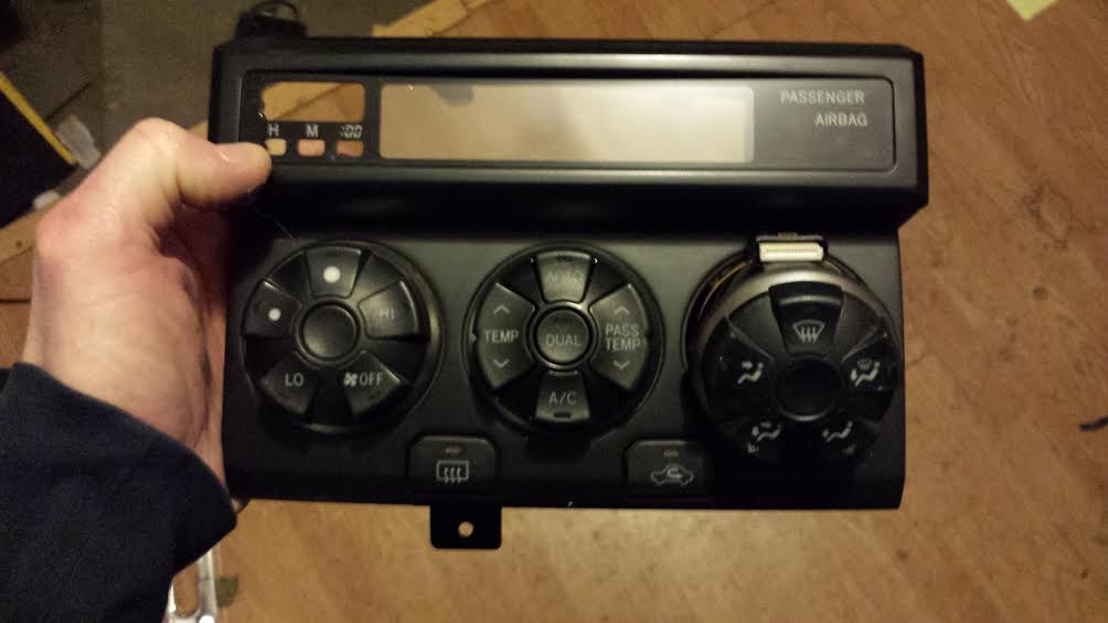

I think the climate control switch panel is not working. Heat comes on intermittently even when I crank it to "HI". Lights on the first switch no longer works. when I press the defrost on the right switch, the recir air light comes on and stuck on until I change air flow to defrost with foot well air.
I'm trying to find a used unit to replace. I have a 4wd Limited, does anyone know if the unit is the same whether it's from an SR5 or Sports edition model?
thanks
The Limited's have a dual climate zone, at least mine does. One of the the three knobs/switches has a button for that function(in the center). That, and the trim behind the switches/knobs is usually matched to the rest of the interior, as the Sport's is just black. In the pic, I have a Sport unit, but Limited knobs, which by the way, has a larger ribbon for the dual climate control knob, and is not compatible to connect to the electronic board. But, you'd be fine swapping whole units.

thanks for the heads up. All I found on ebay were over $00, I guess it's cheap compared to a new OEM unit.
I assume the whole unit is busted because of the problems I'm having. Just hesitant on getting a replacement only to find out it's something else. I'm planning on selling the car within a year.
