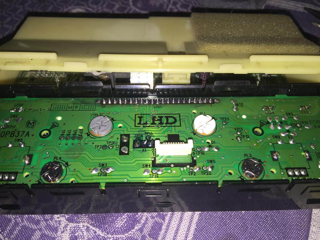

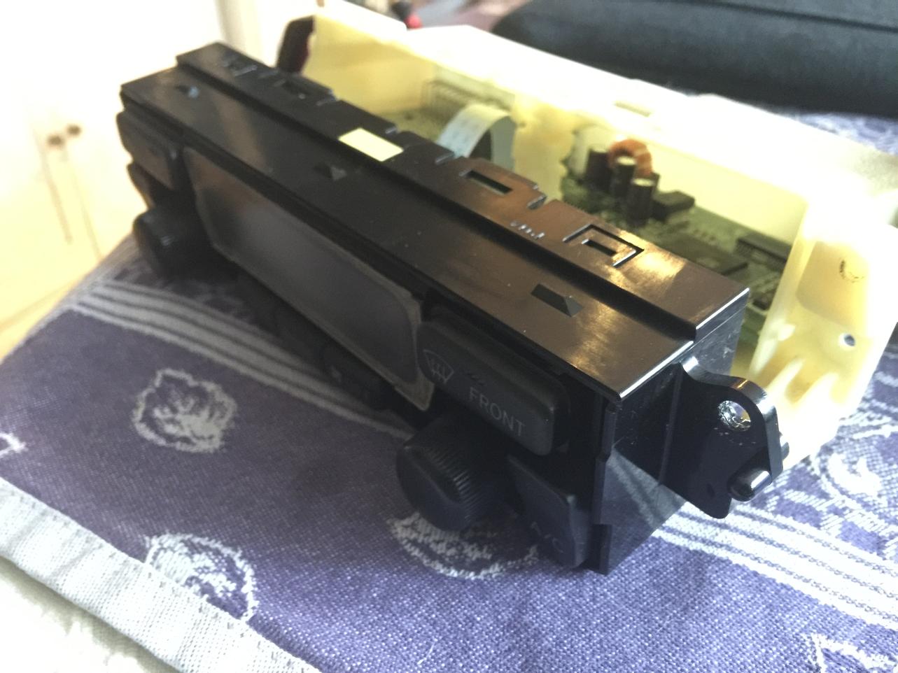

recently got some bulbs in hopes of a simple fix: burnt out bulbs.
after replacing the bulbs and installing the climate control back into the car.... i STILL have a completely dim left side. the bulbs did not fix the issue so what next?
Any ideas from someone that has done this before?

This could be as simple as "one of the new bulbs being bad" or as complicated as a "bad board." There are numerous "Climate Control Repair" posts on Ebay and I know many of the T4R.org members have used them with success. I have seen prices ranging from $45 - $125 for the "send off and repair" services. Might be best to send it off and have it repaired/refurbed and get many more years of service out of it.
When I installed mine 2 of the 4 didn't work, I was able to get them to work by taking the bulb apart by Un wrapping the wires and pulling the emitter and wires out of the base, straightening the wires and reinstalling them in the base making sure the wires weren't touching and it fixed both of them.
yes i agree... this seems to be the best route...
of corse i am plagued with the knobs not doing what i want them to as well when i turn them....
Contact forum member [MENTION=107674]JRZEE2000TR4LTD[/MENTION]
He refurbs these for a very reasonable price.

^^^ This pull the ones out that are not working and rotate 180 degrees. I had the same issue when I put in LEDs
